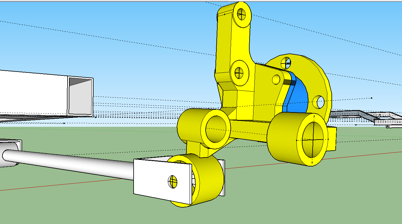

Here's a taste of how it's going!

It looks very much like the rubber control arm bushings were only sold
with the complete control arm. Regardless, even if they were available
separately, they are most likely out of production now. You may get lucky
and find that some bushings crossover into other Toyota models, such
as the Ae92... but I don't have a FWD and have never researched to
see what is possible. Otherwise you are stuck with poly bushings.
Nice drawing... good luck with the project.
