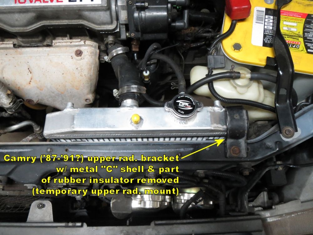

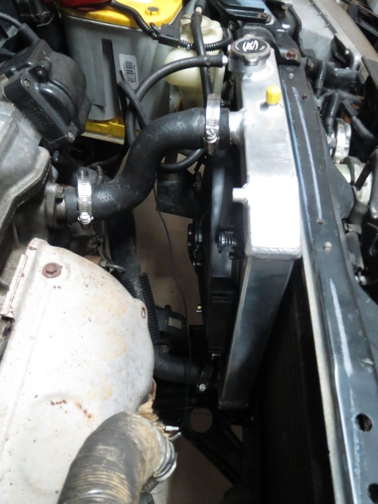

I've seen several pics of AE92s with Civic aluminum (or otherwise) radiators. Most seem to place the Civic rad toward the left side of the car (gearbox side). In doing this, is the LH rad mount bracket used to hold the Civic rad? What is usually done to get the other side of the Civic rad in place? The other side ends up right above the cross brace. I pulled the lower rad brackets from an EK Civic in order to experiment with getting the Civic rad into my AE95.
Just wondering if anyone knows more details before I start drilling, cutting, or removing things. I was looking at the stock rad brackets, and it looks like there's some epoxy or seam sealer type of stuff around the edges of the brackets. They couldn't be "glued" to the radiator support, rather than spot welded...?
