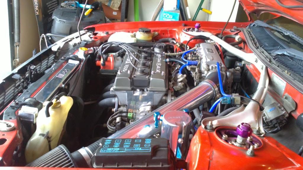

Hello and good morning!have you relocate the battery?and where exactly?thanx

apsogosGTi wrote:Hello and good morning!have you relocate the battery?and where exactly?thanx
Hey yes I have, relocated it to the right side of the boot/trunk in battery box secured to the boot floor with heavy duty well insulated cable from Auto electrician. Also ducting up from under the front bumper to the filter
