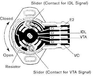

The transition of the engine from "idling" to "running" is controlled by the idle
(IDL) switch on a 4-wire TPS. The switching point is when the wipers just come
into contact with and bridge the two stubby tracks you can see in the above pics.
The switch should be closed when the throttle arm is on the stop or very close,
and open once the arm moves away by a small distance. Operation of the switch
can be confirmed by connecting your multimeter to the two appropriate pins on
the TPS. You are setting the switching point when you use the two different
feeler gauges between the throttle arm and the stop. The procedure is described
in the factory service manual.
Generic image but you get the idea :)
While you have your multimeter out, you can also connect between the ground
signal pins and check how the resistance value changes as you move the throttle
arm. An analog meter makes this very easy as you are looking for a smooth
change in value from closed to open without any sharp jumps or dropouts. If you
find that there is a gap (dropout) right at the moment the throttle starts to come
off the stop then you are looking for a replacement TPS.
