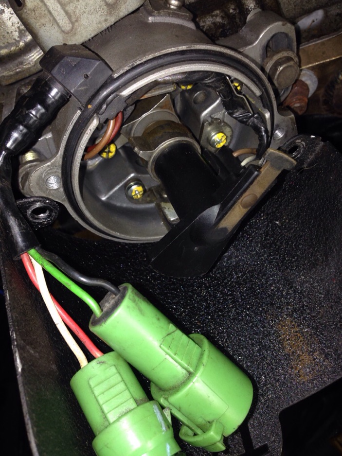

What does an advance curve look like for these engines?
I have a mildly tuned big port 16v(10.8:1 cr; Poncams; 40mm Webers) running a MSD 6al-2 with a straight line from ~10deg BTDC at idle to max advance (~33) at 4000rpm. It runs great, but I am looking to optimize the curve. I am using the stock distributor and do not have vacuum advance.

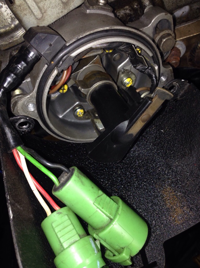

Can anyone please tell me a few things:
1) is the magnetic pickup being used the "4point wheel" as opposed the single point wheel in the distr.
2) which wires would they be? I am thinking in my distributor it is the red and white wire connector (female blades) that go to the red and brown wires inside the distributor. Other diagrams previously posted show green and grey or white wires together and red with black or grey. Kinda confusing for me
3) what wire is + and which is - for the pickup
Thanks!

SR85DET wrote:ImageUploadedByTapatalk1444926286.239930.jpg
Thanks!
7 years and almost 11 months later: The "4point wheel" : red & white (female blades). :)
