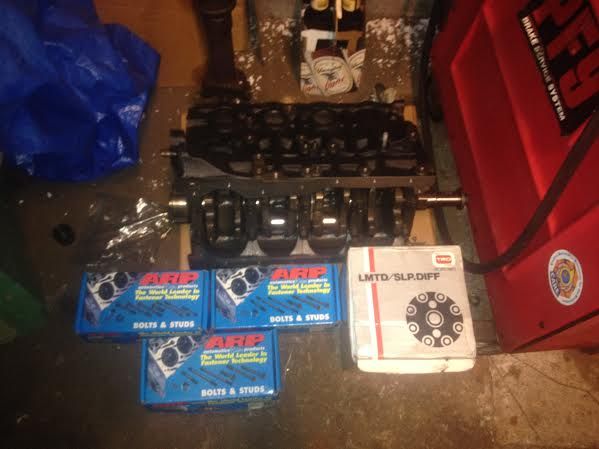

yoshimitsuspeed wrote:I don't want to sound rude but based off your goals and your questions are you sure you aren't getting in over your head?
200 HP even crank HP on a 4AGE is no easy feat and it will not be cheap. You could throw a turbo on there and hit 200 WHP for probably at least a third the price.
What are your goals for the motor?
What is your budget?
Why an NA 4A?
Have you considered the other options?
How much experience do you have tuning motors? even once it's built you have a long road to a well tuned motor making the power it should.
Side note. The only thing making a GZE a GZE is the supercharger, the GZE pistons and the ECU. Remove those things and it's not a 4AGZE and no different than any other 4AGE.
I was thinking the exact same thing. So far a lot of money has been thrown at this thing with no prior planning or research.
Some stuff I think the OP needs to learn about.
- relationship between cams, overlap, and static compression.
- realistic power goals
- how the entire vehicle, is a system, not a pile of parts.
- Race or street car. if this is a street car, you have to drive it on the street. Big Cams, High comp, horrible idle and no cat, will make it a PITA to drive at anything other than full blast.
- emissions and safety. Do you need smog and safety inspection in your state? Are your brakes up to the task? Suspension?
There's a lot more, but i think you get the gist of it.
To tell you the truth, IMO, AE86 is more fun with a mild built 4age, p&p head, 264 cams, high comp(small port) pistons, IHE. Very mild, easy to drive setup. Plus you dont have to rebuild every year. RELIABILITY.
4age is a high strung engine already, too much and it just becomes unreliable.
