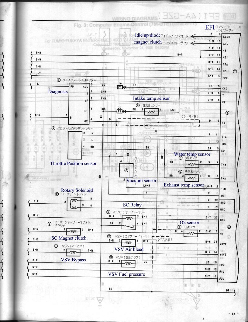

yoshimitsuspeed wrote:You say it makes 7 PSI but never gets any power?
Are you sure you are measuring it right.
It looks like the relay switches to ground so it should have power whenever the key is on. It should then switch to ground. If you get power you might check out the relay. You might also ohm out the stator.
I don't know of anything that would make the ECU cut boost. I don't think I have heard of any such thing.
maxpham wrote:yoshimitsuspeed wrote:You say it makes 7 PSI but never gets any power?
It got 7psi when manually triggered, not by itself. Checked the relay and it had ~85Ω (p1,3). Voltage checks were sat on it as well. The ECU does not power the SMC.
