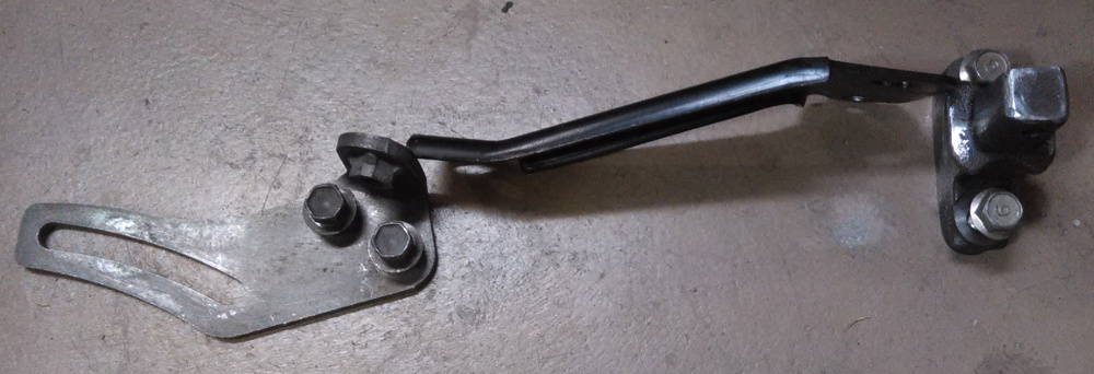

oldeskewltoy wrote:I've yet to see a Toyota application that uses that mount...........
There's a small bracket that bolts to that part of the head. At least for the AE92 GTS. There's a hole in the top timing belt cover for it to stick out of. Then there's a plate which mounts from that bracket to the top of the alternator bracket. I have a pic somewhere of the pieces, I'll have to post it. There may be more to it but I forget. I pulled everything from a junkyard AE92 GTS.
Edit: here's a pic. The bracket is on the far right. I think the middle plate/bracket also bolts to the engine mount. There's 2 holes at that end, one of which bolts to the small bracket situated between the cam gears.

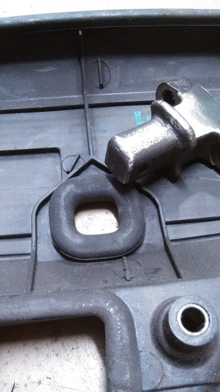

Can you show me this /\ timing cover... all I've ever seen is the typical fwd cover \/...
Re: OST-056: Nasty.....
Posted: Wed May 08, 2019 6:27 pm
by Rogue-AE95
I'm sorry I derailed the topic with this, but I guess we all learn something new every day. And I always love to see your work!
OK, here are some better pics. I had pulled all of the timing covers for my (someday, someday, someday) engine build, along with that small "cam bracket."
^ Bracket looks smooth in parts because I've been taking off the casting lines & imperfections, so that I can get it powder coated along with other parts.
