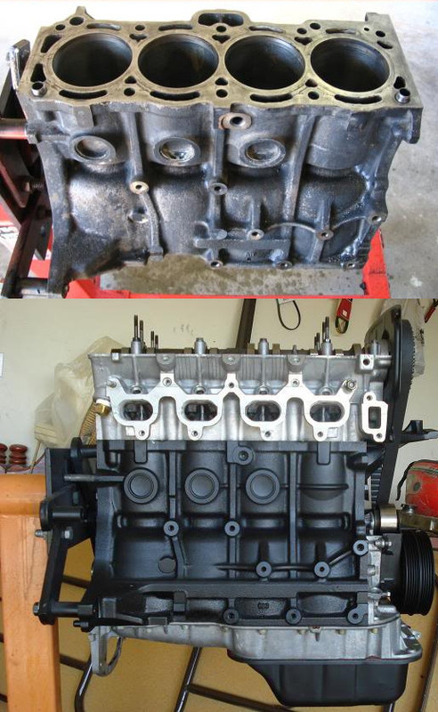

About the 7A blocks, I swear I saw that there were two different blocks. There is one with less support material near the bottom. I'll dig through my pics and see what I find.
Edit: I found the pics I had. Apologies to whoever they belong to as I have no idea anymore. Unfortunately I don't have any further info on years or models or markets (US, JP, EU, AU, etc) that may contribute to these two 7A blocks being different.
I'm 99% sure both are 7A because:
• Knock sensor provision tapped at top of block (I know 2nd gen 4A-FE also has that, but those blocks are 7 rib)
• Bottom left edge of block in pics has cut-out present on the 7A blocks (and 20v oil pans, 2nd gen 4A-FE, and AE95 All-Trac 4A-FE blocks...)
• Whenever I originally saved these files, I named them with 7A because I was looking through sites for 7A-GE info ;)
Note the long reinforcement running the length of the block near the bottom edge. The exhaust side also has that.
My 1994 7A-FE block is like the lower one in the pic above. In fact most pics of the 7A block that I've seen look like the lower one, with that long reinforcement strip. Maybe the version in the upper pic was the earliest, then it was changed? Or the opposite, a very late change to save on material? Or as I mentioned above, market, car model, etc could be a factor.
'88 Corolla All-Trac

That is a pretty significant difference between the two. They look otherwise functionally the same.
