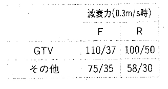

Postby totta crolla » Sat Jan 02, 2021 2:53 am
Some useful information there Jondee, thanks.
My TRD's are 48511-AE881 1127/588N 4-stage adjustable rate Cartridge type
I wonder, should we assume the figures on the far left of the image 'GTV' etc are the standard damper rates?
Piston test speeds would need to be confirmed and possibly converted. It shows 0.3 m/s for the assumed standard dampers.

Postby jondee86 » Sat Jan 02, 2021 1:23 pm
Here is a scan of the same page from a later TRD price list...
https://imgur.com/yAg4mIK
It adds a bit more information in the way of OEM spring rates. I have always assumed
that the GTV rates apply to those JDM AE86 models (Levin, Trueno etc) fitted with the
4AGE and 5-speed transmission. I imagine that the other rates apply to models fitted
with lesser engines where "sports" suspension was not required.

Postby Jayrdee » Tue Jan 05, 2021 6:32 am
Ha, very interesting to see the standard speed setting is 0.3 m/s. While our Quality/Prototype labs run shocks at various speeds, on the assembly lines we run them only at 0.3 m/s and 0.6 m/s since those are the speeds required by the customer.

Postby Jayrdee » Tue Feb 02, 2021 2:02 pm
Hmmm.. now this is interesting.
So, totta crolla might be sending me a 48511-AE881 front shock, so lets compare that to the HTS 112 front.
HTS 112 front at full soft:
Rebound = ~0.5 kN @ 0.3 m/s
Compression = ~0.5 kN @ 0.3 m/s
According to the scan that Jondee posted, the 48511-AE881 front (im assuming these were all tested at full soft):
Rebound = 1.519 kN @ 0.3 m/s
Compression = 0.588 kN @ 0.3 m/s
So the TRD shock obviously has way more damping force on rebound vs the HTS. But whats even more interesting to me is that the GTV specs are 1.078 / .363 kN
So does that mean that the stock GTV shocks have more damping force on rebound than the HTS at full soft? Rebound is usually whats affected whenever you have shocks with dampening adjustment, and the HTS at 4 turns is a little under 1 kN, which is still not as much as stock GTV shocks. So in theory the HTS shocks would feel "softer". I wonder the reasoning behind that.
This is just going off scanned data too. This is why I want to get my hands on the real thing and test them!
