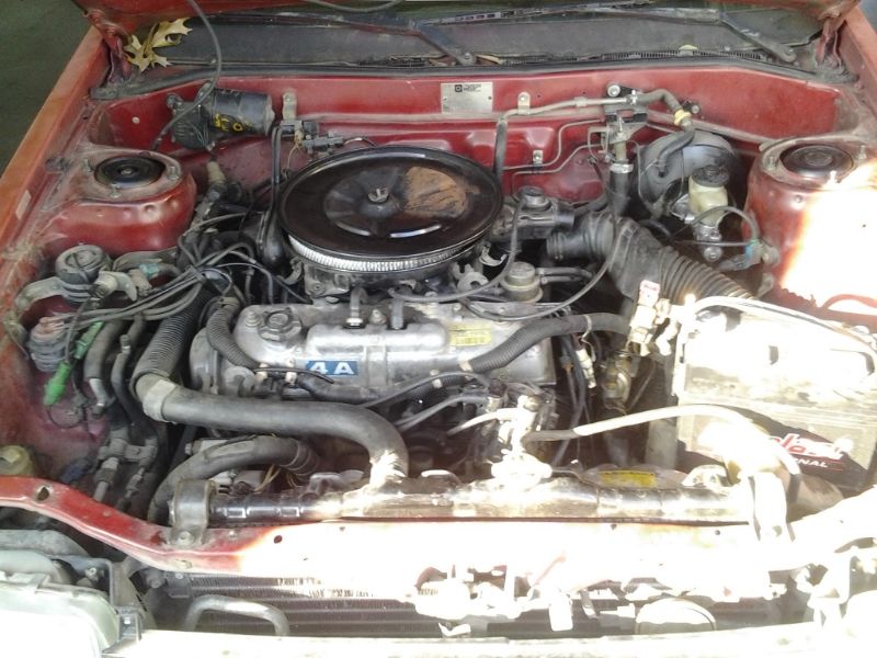

First thing done was to replace the worn-out struts, and the front strut mounts. In order to get it running properly, I did a vacuum delete, and swapped to a weber 32/36 carb. The difference was night and day. Sounds good, better power, and a stable idle. I need to figure out a better air cleaner, I just don't care for open-element filters being trapped under the hood.
Went from this:
To this:

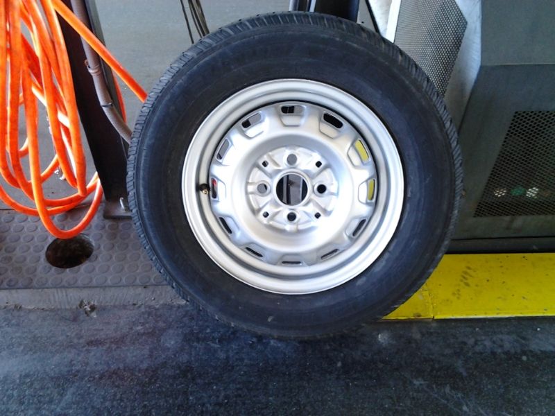

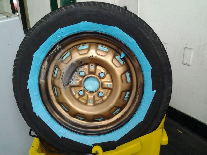

Still need to finish up removing the emissions items, and replace a couple of engine mounts. In the mean time, fueled by a extra-caffeinated coffee blend and cold medicine, I decided to strip the factory steelies of the nasty gold and black paint, And repaint.
From this:
To this. Much better, OEM style :mrgreen:
Now I just need to find three more center caps.

Wow, nice job on those wheels! :D Is that just spray paint?

Thanks, It's just Duplicolor wheel paint. I stripped them to bare metal, primed, sprayed them silver, and finished up with matte clear. It really made the car look less trashed out. :lol:

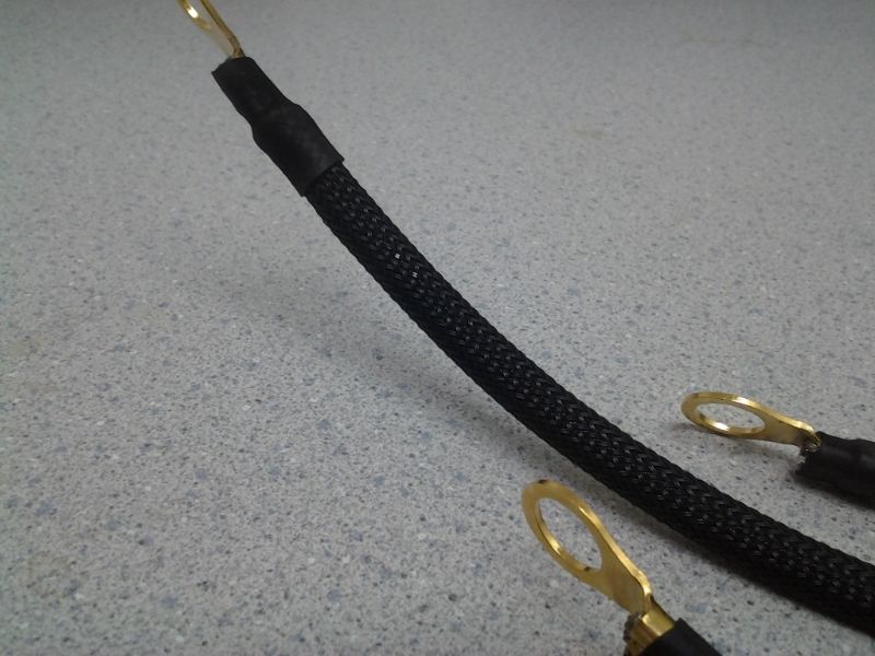

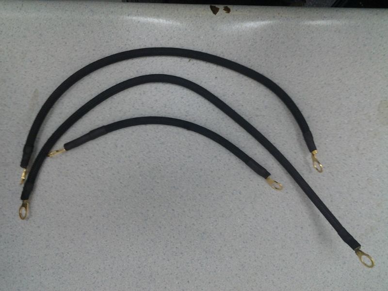

The electrical system seemed weak, So I fabbed up some new ground cables.
Love this wire braid loom..
Lights are a bit brighter, wipers are a bit faster as well. Still needs improvement, though.

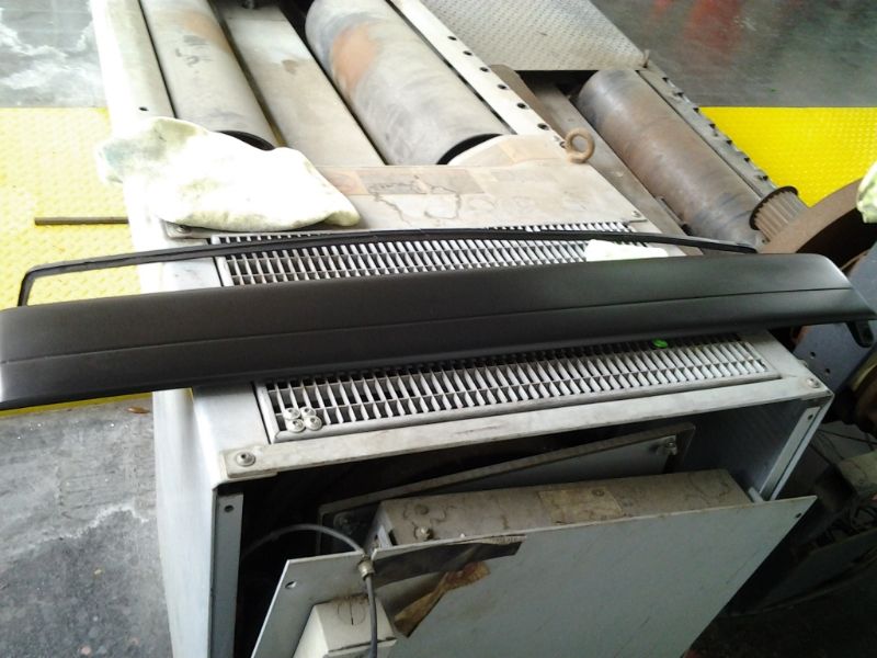

Sanded and painted the spoiler. I think I may go with this semi-flat finish on the bumpers and other plastics later on, I'm not sure.
