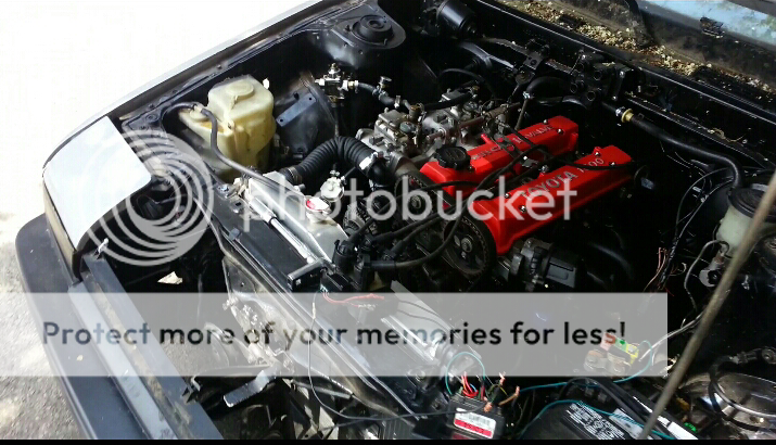

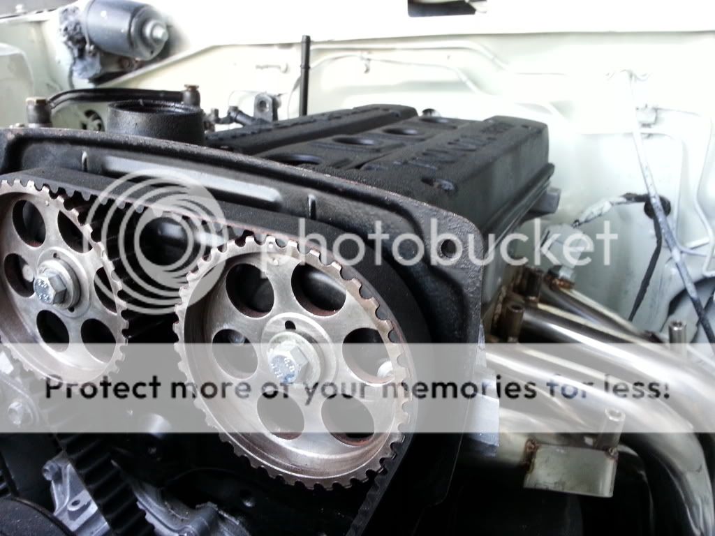

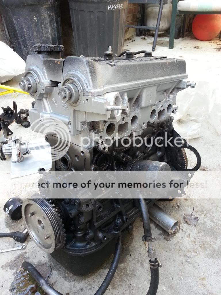

Hey wassup everyone. After countless night of doing research and browsing this site. I figured i would make a account and post some pics.My car is a simple build. I have a lot of big dreams for it, but unfortunatly this is were my car is at. I have a rebuilt engin, stock rods,pistons, crank. Only upgrads to the block have been some arp bolt for rods and main. Head is compleyly stock. I switched the intake to some dcoe mikuni solex carb. And i set up a edis 4 with a megajolt. Not expecting power from this. It more of a shallow build focusing on looks and fun factor.

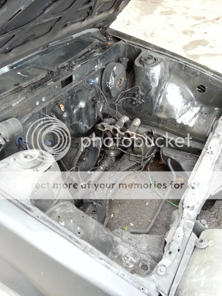

Before the fire!!!!

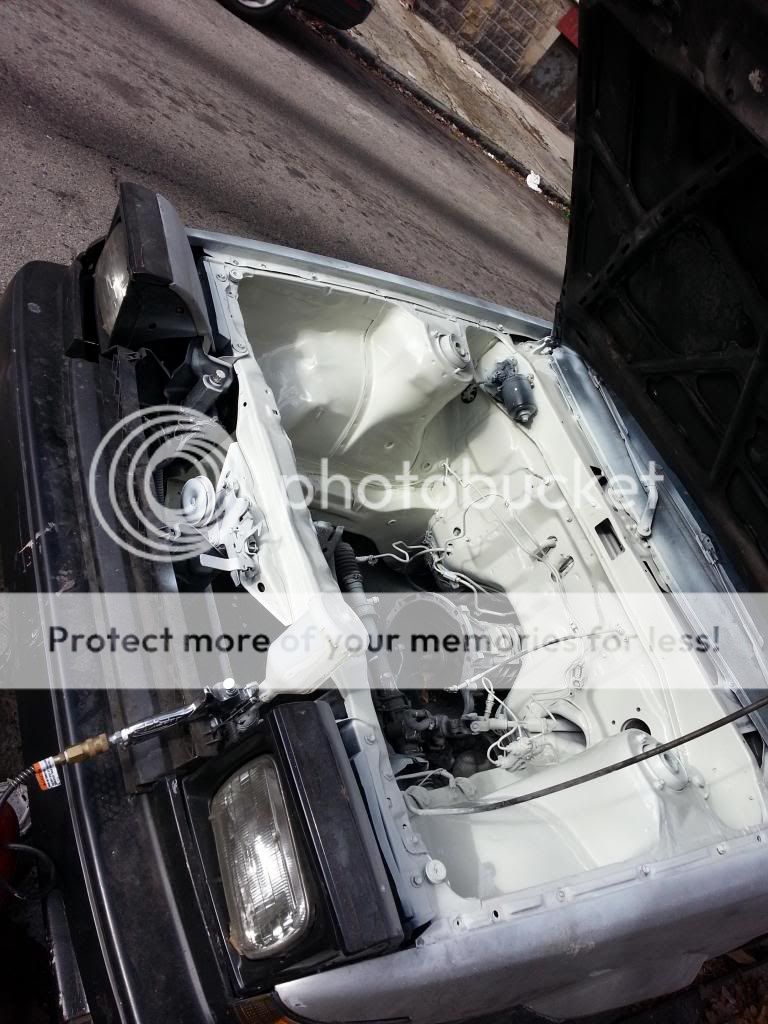

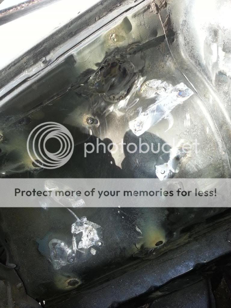

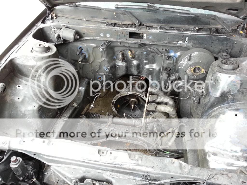

The fires aftermath...

Oh man, that blows. Sorry dude!
Where was the fuel leak?

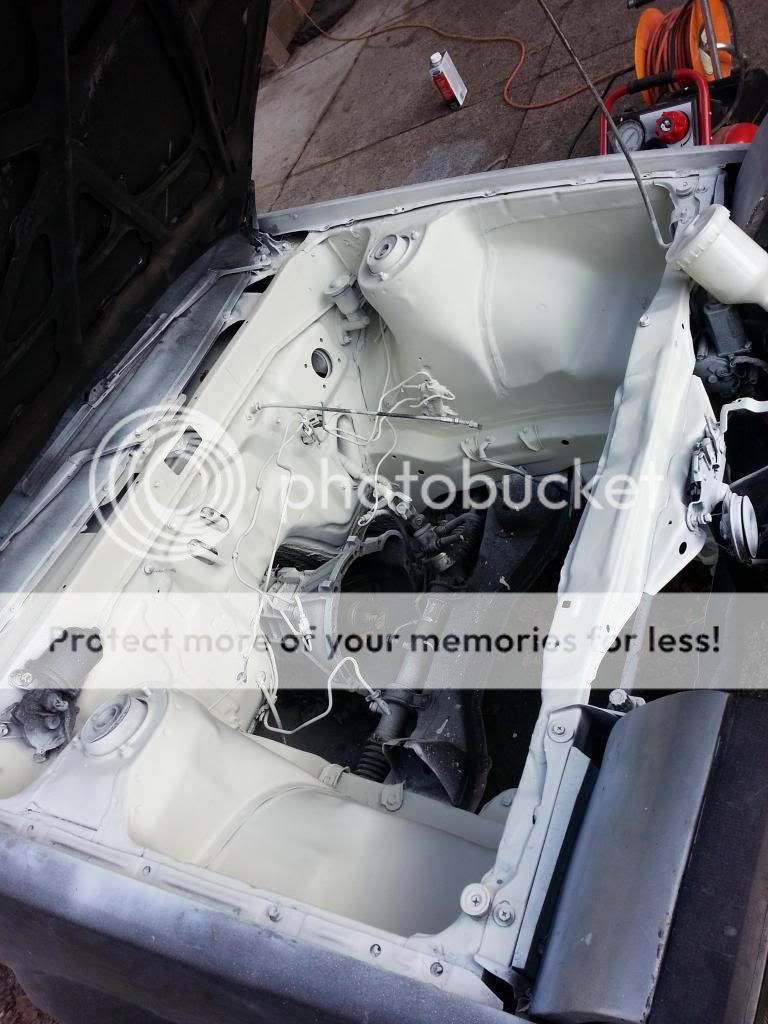

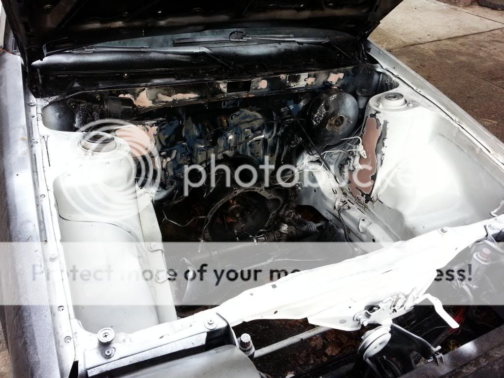

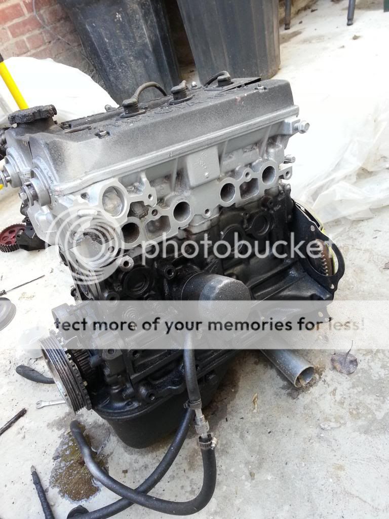

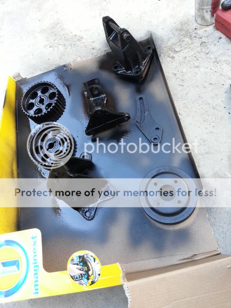

Yea it sucks. But im getting the car back together lil by lil. And the leak seem to have come from bottom of one of the carbs. With that and having the fpr and fuel pump directly in front of carb opening it was a recipe for disaster. Ill post more pics soon. The engine bay is coming along pretty well so far.

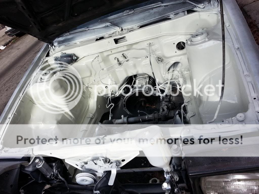

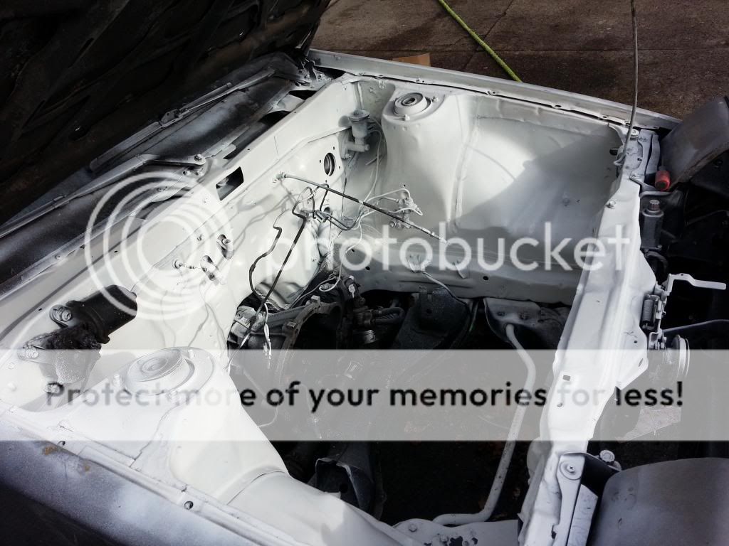

I hit the junkyards up got a 2nd edis 4 and some coil on plugs from a mid 90's camry. Wired it all up with my exsiting edis setup and got her started. Just have to dome cleaning up and some final touches and she will be on the road again.
