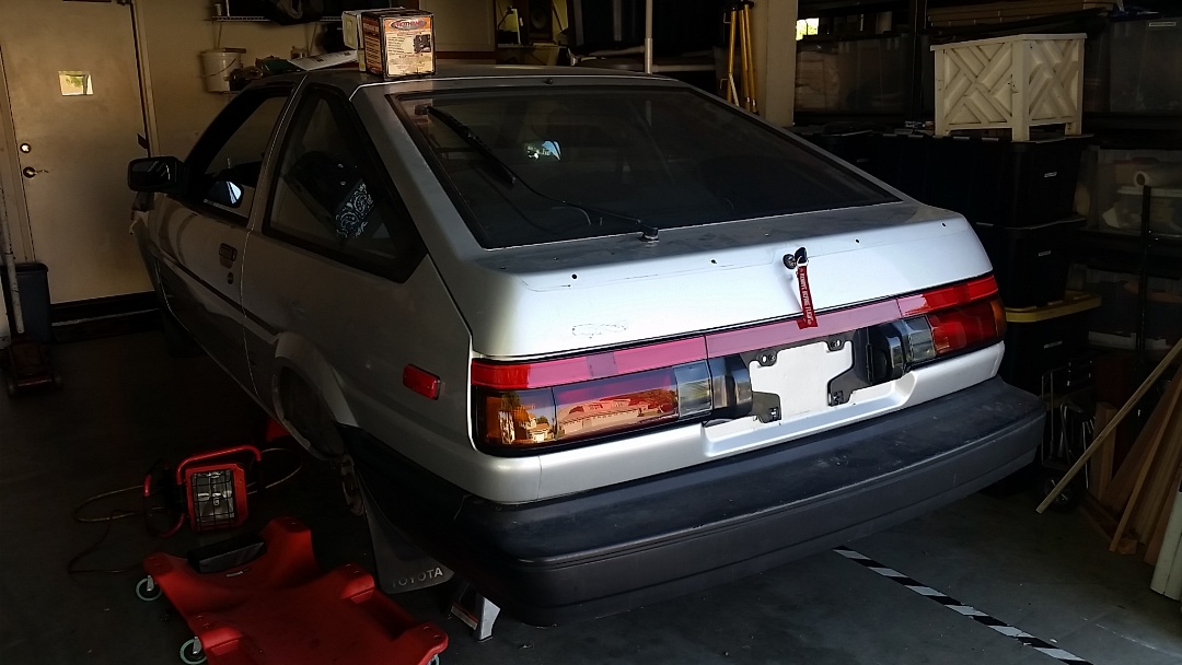

Here She is. that's my buddy Marlon handing her over

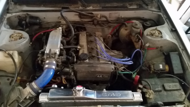

Here She is when I got her home and emptied all the random parts out and popped the Hood

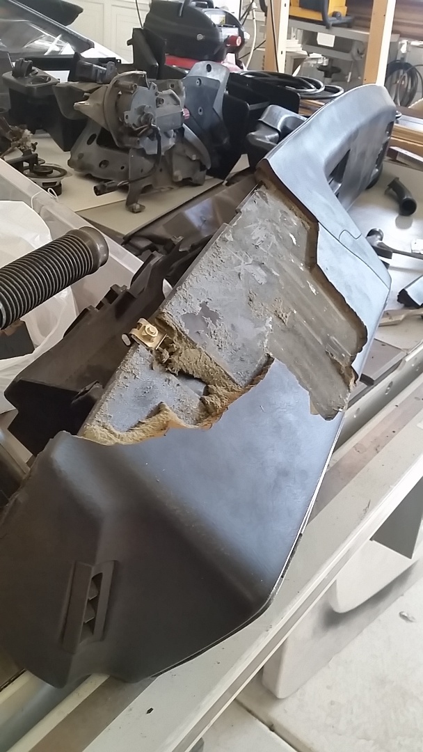

Postby hachi-6 D0ri » Fri Mar 27, 2015 2:21 pm

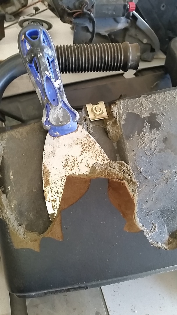

Here are pics of the inside and all the wiring work I have to finish. Kinda of a nightmare. And I'm pretty sure the engine harness is zenki while the dash harness is kouki

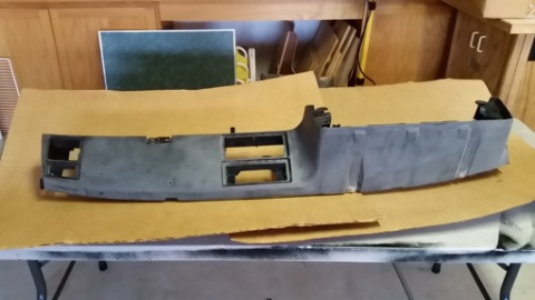

I also decided to strip the dash and paint it due to the fact that it was so charred and dry from sun damage. This is just temporary until I find a dash worth buying or restoring.

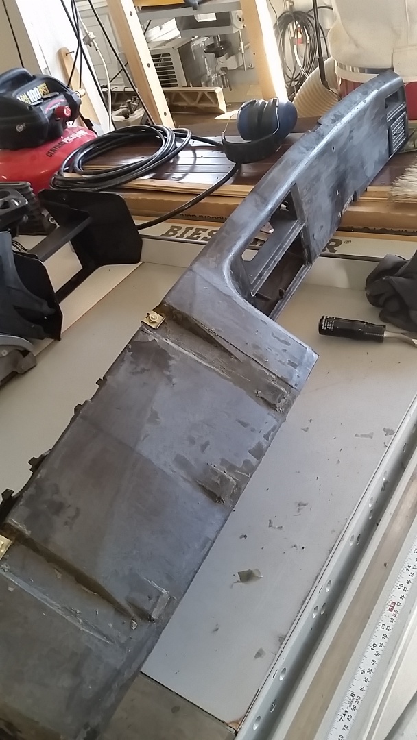

Postby hachi-6 D0ri » Fri Mar 27, 2015 2:24 pm
Did not come out as clean as I wanted it to but not bad

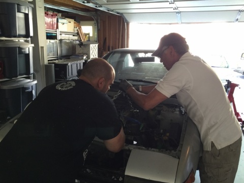

Decided I needed to pull it apart to see what was really going on. Turned out to quite the nightmare and a lot of experience for my wife
If your not crashing .. Stop being a p**$y Go hard in the paint!

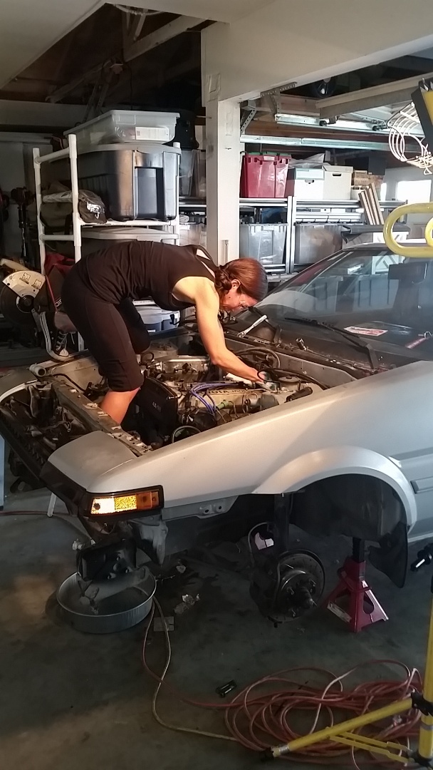

Postby hachi-6 D0ri » Thu May 28, 2015 9:53 pm
Had Jess do the work

Postby hachi-6 D0ri » Thu May 28, 2015 9:55 pm
Well most of it had to jump in to help

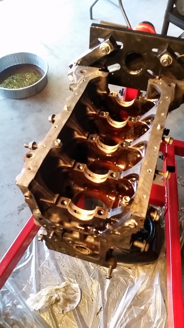

Postby hachi-6 D0ri » Thu May 28, 2015 10:02 pm
The block was clean but some of the crank bearings where pretty nasty and the crank has to be replaced. Head is nasty so I'm going into take it into Amazon motors in Huntington. There is a little Peruvian genius there who is going to go to town on it.

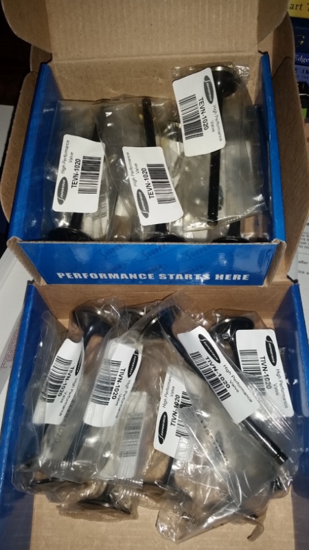

Postby hachi-6 D0ri » Sat Oct 24, 2015 1:00 pm

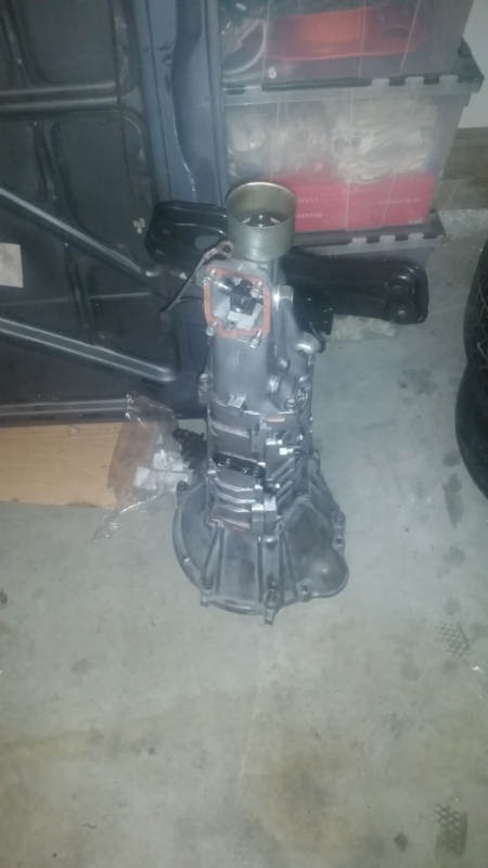

So I sent the head in to get work done . Port matched , all new valves frome supertech, new valve seats, has valve springs and all the works. I also finished cleaning up my transmission. Put all new seals and gaskets along with a cusco tans mount .

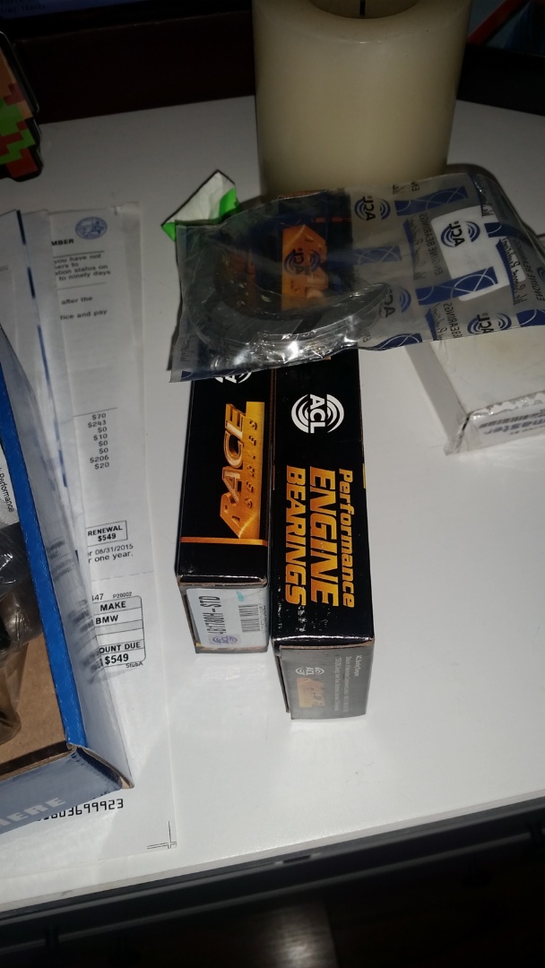

I ordered new bearings and shims for the bottom end along with a new clutch and lightweight flywheel . And I hit my first problem . This is why you can never try and cut corners if your going to do a mid to hi end build . So I thought I would save some cash and get this clutch kit from "eClutch masters" which was a mistake only because I'm getting my bottom end balanced . The balancing shop called me and told me the pressure plate sits on the flywheel dowels loose and and would be a degree or two off any time I removed it . Wichita in turn will set everything out of balance so they could not use that clutch and flywheel . I have been on a wild goose chase for the past two weeks trying to find a shop that has a hi end flywheel and clutch kit they could source or had in stock . No luck so far . [emoji20]

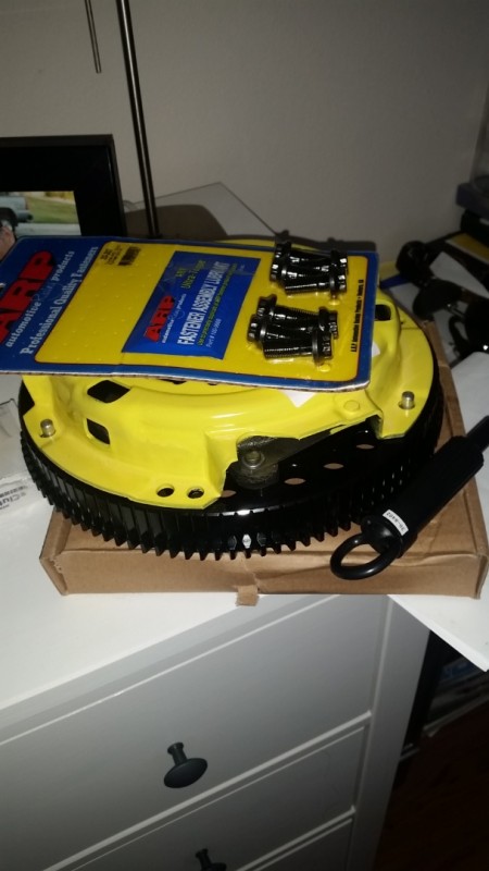

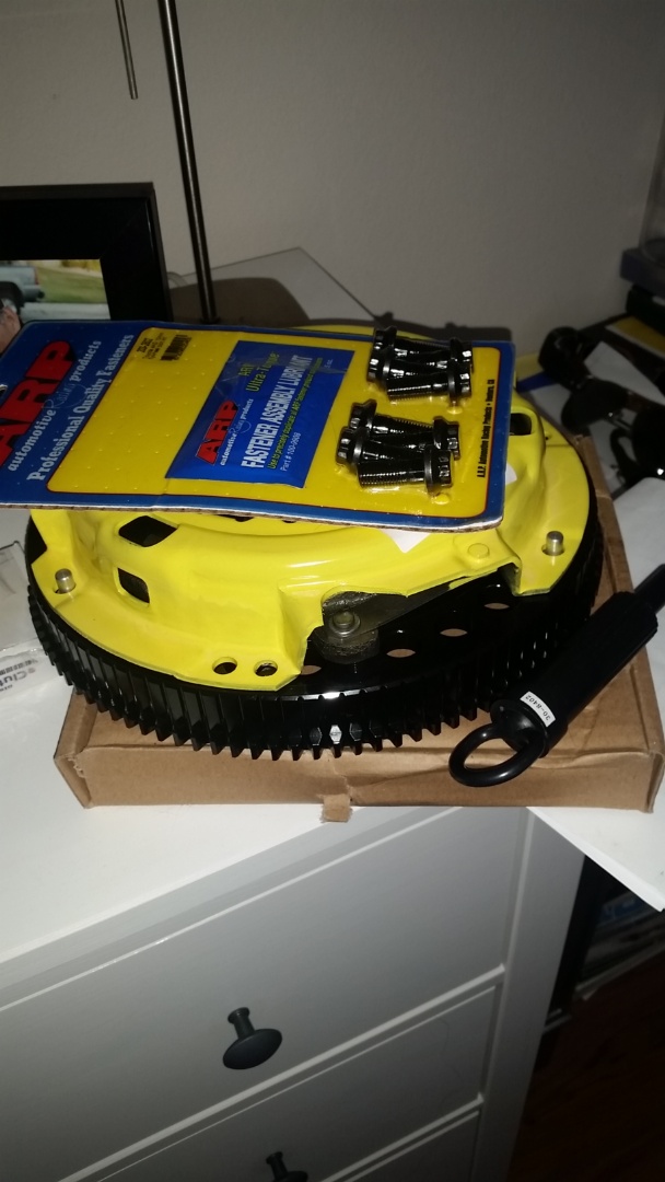

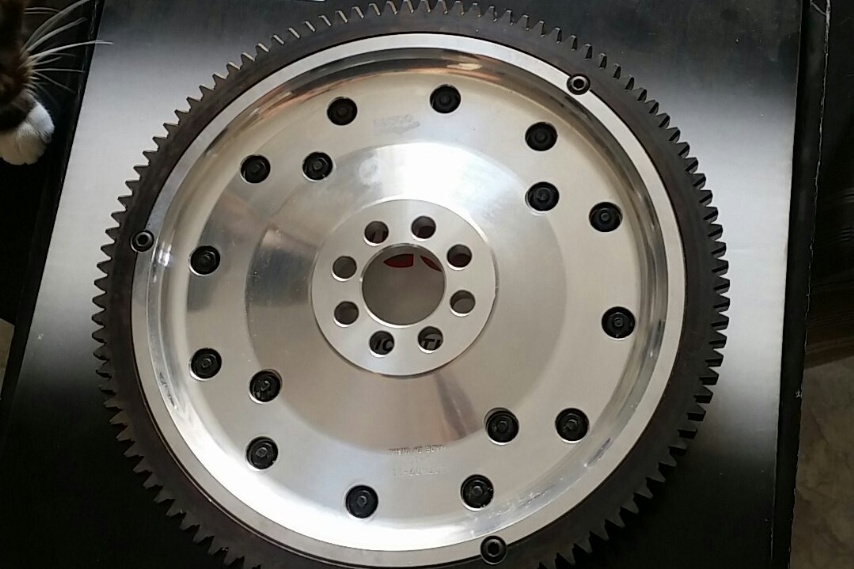

Postby hachi-6 D0ri » Mon Oct 26, 2015 3:19 pm

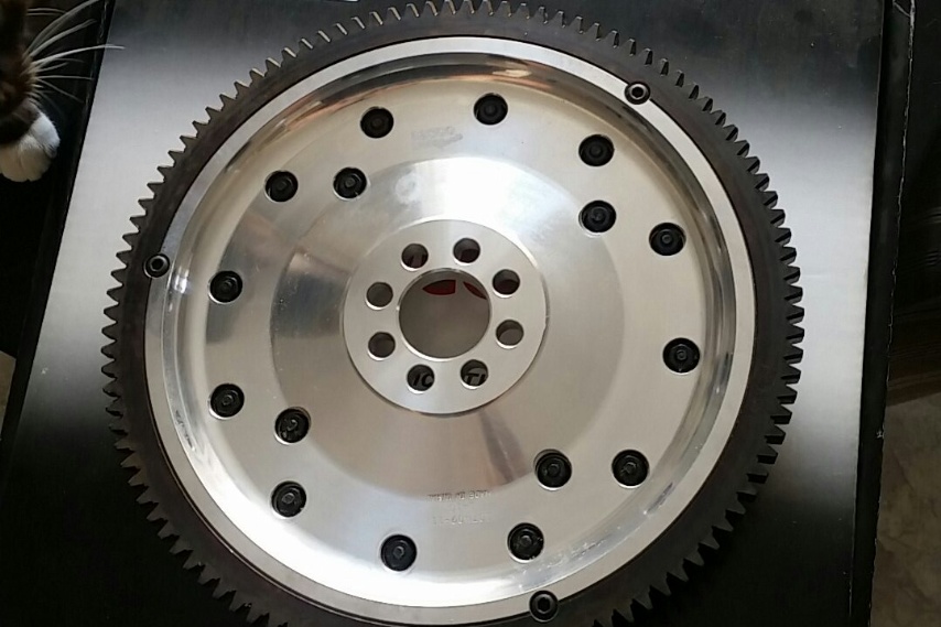

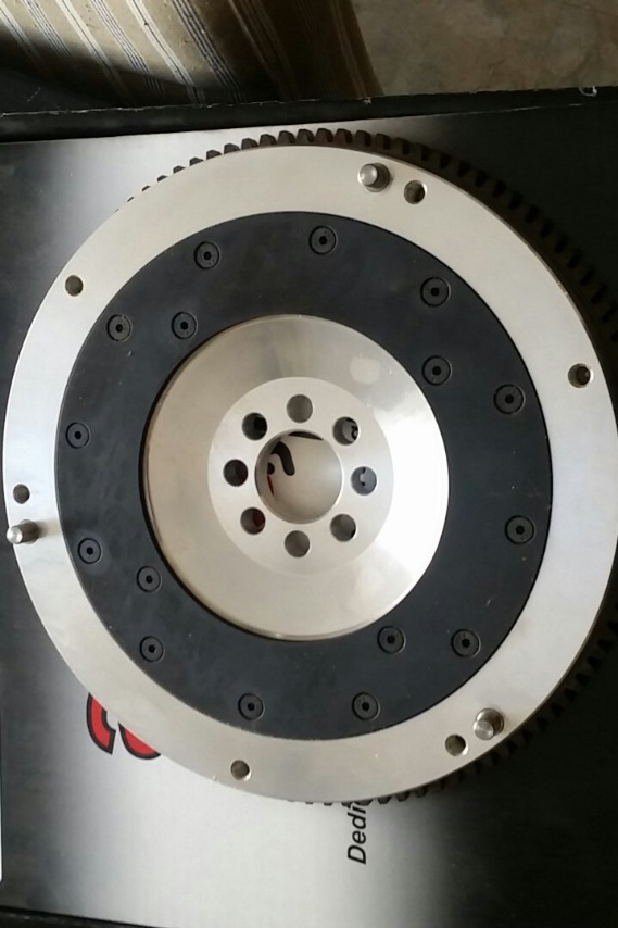

Ordered a proper flywheel from options auto salon. They have pretty much everything you could need. Ended up buying a 200mm 8lb aasco flywheel . Pretty sweet. Also ordered a 3 puck exedy clutch from my buddies at frsport. Got the flywheel in . But still waiting on the clutch

Postby mad_86 » Tue Oct 27, 2015 4:35 pm
hachi-6 D0ri wrote:I ordered new bearings and shims for the bottom end along with a new clutch and lightweight flywheel . And I hit my first problem . This is why you can never try and cut corners if your going to do a mid to hi end build . So I thought I would save some cash and get this clutch kit from "eClutch masters" which was a mistake only because I'm getting my bottom end balanced . The balancing shop called me and told me the pressure plate sits on the flywheel dowels loose and and would be a degree or two off any time I removed it . Wichita in turn will set everything out of balance so they could not use that clutch and flywheel . I have been on a wild goose chase for the past two weeks trying to find a shop that has a hi end flywheel and clutch kit they could source or had in stock . No luck so far . [emoji20]
Speaking of cutting corners!!! ,I recently seen a 4ag Flywheel Completely come off , ALL reused oem flywheel Bolts Broke off, sh*t happens
(not to point fingers or make fun of any1 but more of a serious PSA, but it Does happen ppl! lol)
