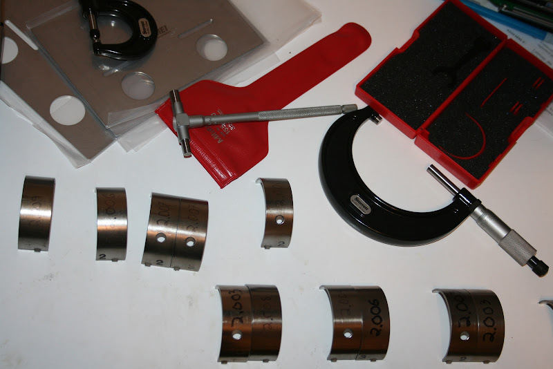

Then I cleaned up some bearings, measured, and labeled them.
rod bearings came in and got measured out. Not bad.

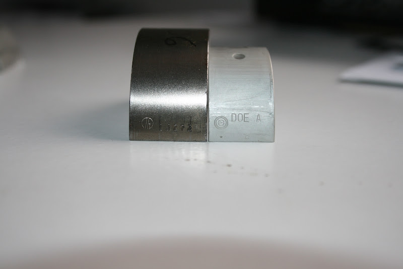

Bearing on the left is a main. Bearing on the right is a rod.
All of the OEM 4A-G main bearings I have are made by
TAIHO. 42mm rod bearings are also made by Taiho.
Those 40mm rod bearings, and all 40mm 4A rod bearings I've seen, are marked with that logo. Power Enterprise F1 Black bearings are made by the same company, as are all of the Clevites I've seen for the 4A. I believe it's for
DAIDO bearings.
