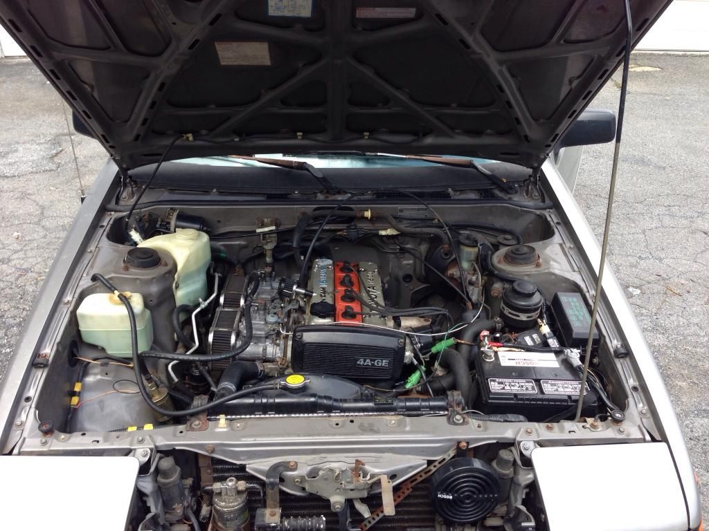

What's up guys! I purchased a 85 AE86 with Mikuni carbs already installed 1.5 years ago and currently looking to make back to EFI. I drove the vehicle 1.5 hours back to PA from NJ and she drove good with no issues at all. I am looking for advice on what might be needed to return back to EFI and what am I up against. Fyi I won't be the actual work because I don't have the skills point blank : ( .

Need more information.
Are you going to stock engine management? Or Aftermarket?
Was the car originally EFI? If so how much of the original wiring is there?
If not then how is it currently wired?

You'd need the entire airbox set up from intake flange to air filter. fuel injectors and all the appropriate wires for those parts to work properly, and probably a new distributor too if your current one is "locked out" on a certain timing. But The main thing you need to look for is how the injector ports were plugged up. Hopefully they weren't welded shut like my carbed 16v Image

intake manifold
TVIS plate with all components
rwd throttle body
AFM and airbox, or pod filter
intake tube
vacuum lines correctly routed
EGR system - valve and hardware
BVSV valves

You would also need your:
Ingnitor Coil
Ingnition module
Chances are you'll probably need GTS Engine bay wiring harness and ECU
