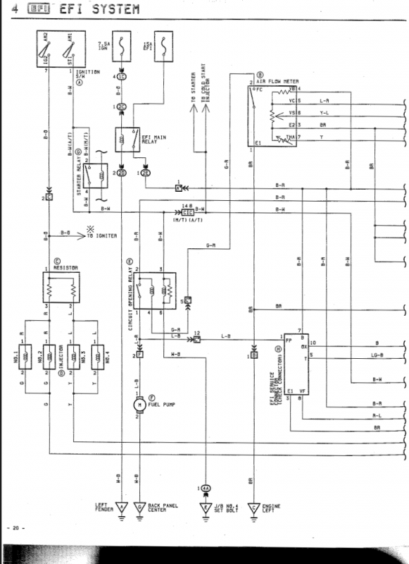

for the oil pressure problem-are you using the old sensor from the 16v OR the 20v sensor? the 20v sensor will not work with the cluster, its a "dummy light' not a gauge.
the tach problem-the stock tack will work fine using the 20v igniter, when wired up properly. you need the 20v coil and igniter connected to the harness tho. see here for proper wiring. the tach wire from the igniter goes thru the large firewall plug above the head. http://img69.imageshack.us/img69/1424/2 ... 86cops.jpg
the COR, how did you wire it up from the ecu? it should be like this, pin#5 on underdash plug to FC plug on ecu.

Re: Persistent COR and gauge problems, 20V swap
16V oil sensor, I know the 20V is basically useless.
I've wired the tach according to a similar diagram, but I use 4-wire Denso COP's. Same setup in the end.
I am running FC to this plug.
I have run through the DIY thread dozens of times, this is actually my third iteration of a harness. It actually turned out to be pretty great, except for these few issues.

I don't know about the US cars but the Euro and Jap cars have a Green and Red wire that comes out of the COR and the ecu grounds this wire via the pin FC.
Also the +B supply for the ecu comes from the engine bay relay box through the engine harness and into the passenger side junction box, if you don't have this you probably are only switching the COR on when cranking the starter.
On the RHD cars the 5 wires in the COR are (the COR has 2 relay coils inside, 1 that's latched when cranking and the other latched once the ecu reads an RPM greater than cranking speed)
Black and White: Starter solenoid signal
White and Black: Earth for the starting relay coil
Black and Red: +B supply for engine running relay coil
Green and Red: Ecu controlled ground for engine running relay coil
Blue and Black: Switched fuel pump power supply
I've attached the two pages from the Parrot USDM electrical service manual.
So it's obvious not that I was wrong about the ECU providing power, which should really have been obvious. What isn't though is why the relay isn't working, any ideas? If I connect up the pump back to the relay, the car will crank but won't start and the relay will buzz after I stop cranking.

My mistake, the diagram does show the line being supplied by the ECU, but also crossed with a B+ supply from the C*? Am I going mad?
The only reason I can think of why your COR would be buzzing is that you
have a high resistance connection on the battery side of the RUN coil. You
need to check the supply voltage at the RUN coil when the engine is trying
to start. You will probably see 12V prior to hitting the key, but as soon as
the engine is spinning the voltage will drop to maybe 4-5V... if this theory
is correct
And if the voltage is not high enough to latch the relay, the engine dies.
is correct
Sorry for the late update, but I've finally gotten the dash off for an HVAC repair so I thought I'd work on the COR.
First some good news, the relay works between pins 3-6. That's the only good news.
The bad news is that between pins 1-2, which actually run the relay, there's no voltage on crank. Consulting the wiring diagram, I can say that it's supposed to be fed via the EFI relay in the engine bay, which is working and shows voltage across its fuse. Question now is, where is the break in the system? I'm tempted to completely remove the dash and find out (The dash itself is still in the car, I only removed the plastics).
Thoughts are welcome
Sent from my OnePlus
