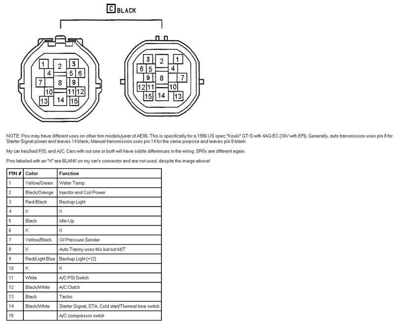

4. On wires E21 & THW they show to connect together (E21 being a ground and THW being the ground side of the sensor). Am I wrong or does this mean I need the single prong connector for the dash gauge and another sensor for the MS? I believe this to be the case since the single prong sensor will not have a ground going to it.
5. All the ground wires used to run to the intake of the engine, I would like to move them to the block so they are hidden. This will be fine as long as I have a ground wire going from the engine to the body of the car correct?
6. Does anyone have a higher resolution of the schematics I have attached below, or know where they have come from? I can't make out half the letters/numbers on it and it would help tremendously with figuring out what I do and do not need for the C plug.
I have also attached the helpful printouts from the MS website concerning what needs to be kept and deleted.

If you ground on the block follow the MS instructions. You need to keep away from the
starter and alternator. Make sure you have one fat ground wire from beside the starter,
plus one medium wire from the head and one from the block on the intake side.
I'll see if I can find something. Here ya go... best I can do, so hope it helps
https://app.box.com/s/8jyifhvj5y3e9f4jp7yzxafjfnqa73fe
https://app.box.com/s/l9bjya0gaqhzvslafsyb1nrqs7ded0mg

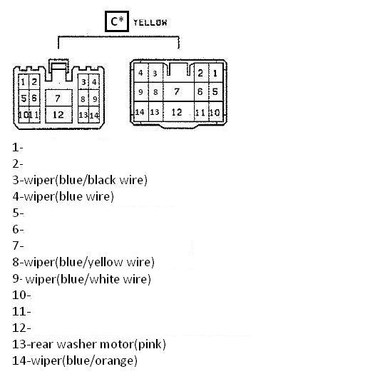

Re: Megasquirt/7AGE/Custom harness questions (Wiring Guru he
Here's all the data I used. I'm pretty sure it's right. I traced most of it out by hand on my existing harness.
- Attachments
- C Star Plug.png (81.88 KiB) Viewed 31087 times
- C Star Plug Wipers.jpg (30.34 KiB) Viewed 31087 times
- C Plug.jpg (56.68 KiB) Viewed 31087 times
Here's what I traced out by hand after using those documents. Only wire I'm somewhat concerned with is the one coming off Pin 2 of the C Plug. It seems to go to a ground like unit over by the brake plunger system. I'm wondering if it's needed. I'll try to post pictures of it tomorrow.
C* Plug
Pin 5 Green Red
Pin 6 Blue Red
Solder together at the C* plug to power on Fuel Pump when Started
Pin 7 Black Red
Splits to 3 locations
1 goes to TVIS (Don’t need)
1 goes to AFM (Deleting)
1 goes to Black single pin plug (Runs to fuse box)
Windshield Wipers
Pin 3 Blue Black
Pin 4 Blue
Pin 8 Blue Yellow
Pin 9 Blue White
Pin 14 Blue Orange
C Plug
Pin 1 Yellow Green (Water Temp)
Goes to single pin water temp sensor
Pin 2 Black Orange (Injector and Coil Power)
Goes to Green plug for Igniter/Coil
Goes to 2 pin blue plug (Possibly to fuse box)
Goes to resistor box plug (This is the wire the injectors will tie into)
Pin 3 Red Black (Back up Light)
Pin 9 Red Light Blue (Back up Light 12v)
Goes to transmission switch
Pin 13 Black (Tach)
Goes to Ignitor/Coil green plug
Pin 14 Black White (Starter signal)
Goes to Starter
C* Plug
Pin 5 Green Red
Pin 6 Blue Red
Pin 7 Black Red
Windshield Wipers
Pin 3 Blue Black
Pin 4 Blue
Pin 8 Blue Yellow
Pin 9 Blue White
Pin 14 Blue Orange
C Plug
Pin 13 Black (Tach)
Goes to Starter

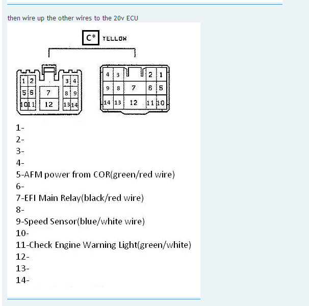

Jondeezy,
Riddle me this, which one of these is correct? Both show something different for Pin 9?
- Attachments
- C Star Plug.png (81.88 KiB) Viewed 31034 times
- C Star Plug Wipers.jpg (30.34 KiB) Viewed 31034 times
Yes... had to happen sooner or later
According to the wiring manual for the 1987 USDM AE86, the pins
for the C* plug are identified thus...
1 = THA
2 = VS
3 = Front Wiper Lo
4 = Rear Wiper/Washer
5 = FC
6 = VC
7 = +B1
8 = Front Washer
9 = Front Wiper Park
10 = E21
11 = CEL
12 = FP Test
13 = Rear Wiper Washer
14 = Front Wiper Hi
The Blue-White speed sensor wire can be found in the same
general location as the C* plug, but does not connect to it. The
SPD wire connects to the R10 plug (third ECU plug on the body
side harness).
Ahhhh.... that feels better

So, I was getting ready to solder these last few wires and noticed something.
Pin E2 that connects to C* Pin 10
and THA that connects to C* Pin 1
are not part of the engine harness. They are the A plug for the ECU and do not have any wires that connect them together that I can see on the factory harness. Do these tie in through the ECU or what? My mind is quite boggled. That plug is still inside the car currently since it was not part of the engine harness.
Thoughts?
Thoughts?
Just traced both harnesses I have and the ground is cut on both coming off the TPS...
c4ptiv3 wrote:Do these tie in through the ECU or what?
Mine is not to try and understand the workings of the inscrutable Oriental mind
I restrict myself to studying the ancient diagrams and scripts to divine in which
directions the ineffably small electrons might be flowing. And in this case I have
discovered that...
THW sensor ground ==> C*10 ==> E21/R12
TPS sensor ground ==> C*10 ==> E21/R12
AFM sensor ground ==> C*10 ==> E21/R12
THA sensor signal ==> C*1 ==> THA/R3
THW sensor signal ==> THW/S10
Which says to me that the sensor ground wires must be spliced together before
they get to the C* plug. It also appears that all the AFM wires must get bundled
together and brought into the car before feeding back to the ECU via the C* plug.
Can't comment on cut ground wires other than the fact that there is usually a
ground wire from the AFM for the switch that controls the COR/FP circuit. This
is a chassis ground and separate from the sensor grounds.
