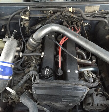

problem is the first owner built this and previous owner had no idea either so I wouldn't know where to start haha
- Attachments
- that's what I have
- image.jpg (74.5 KiB) Viewed 9179 times
