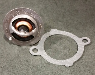

How to test your thermostat out of the engine. The valve flap thing should
be closed. Drop the whole thing into a pot of boiling water. The valve should
open about 3/16" - 1/4" once it gets up to the water temperature. If the
valve is already open when you take it out of the engine, it is no good.
The end you see in the pic goes towards the radiator, and the jiggle valve
goes at the top.
