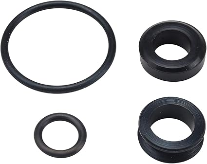

Are you telling me i don't even need to replace anything and i can just throw it back on without the bottom orings? LOL please explain!
jondee86
Posts: 2948
Re: 20V Black top Fuel Injectors question
Postby jondee86 » Wed Feb 12, 2020 2:25 am
Just realised I hadn't replied to this thread, and that I probably gave some
bad information :oops:
On side feed injectors the two O-rings marked in red stop the fuel leaking
top and bottom. The insulator marked in green looks to actually be a fat O-ring
and it seals the injector against the manifold to stop vacuum leakage and also
insulates the nozzle against heat transfer. On top feed injectors the insulator
is usually a fat square-section O-ring.
This diagram indicates a second O-ring insulator at the top of the injector, and
this does not actually seem to happen on side feed injectors. On top feed injectors
there is always an O-ring close to the top to seal the injector to the fuel rail. On
the AE111 some injectors have a flat rubber "washer" on the top but others don't
have this ring. It does not actually seal but probably provides a bit of a cushion
for the steel injector retaining clamp to press down on.
You will have got this all figured out by now so just tidying up loose ends :)

you can purchase the parts at a dealer.
Top & Bottom Insulators - 23291-75010
Upper O-Ring - 90301-17007
Lower O-Ring - 90301-14006
OR look for a set for the 1J injectors at the local parts store.

morgan wrote:you can purchase the parts at a dealer.
Are you saying the 1J injector o rings are the same for the black top?
Ahh those insulators I can get them at any toyota in the USA?
Also looks like the Top insulator is smaller than the bottom one? bottom one is super fat while top one i had was skinny..
Nick94tt
Posts: 253
Joined: Mon Jan 13, 2014 9:43 am
Postby Nick94tt » Wed Feb 12, 2020 9:10 pm
Swooki wrote:Ahh those insulators I can get them at any toyota in the USA?
Per some quick cross checking, the MK4 turbo supra injector kits look like they may work. (93.5-98 in the US)
Compare what you have to the photos/order a set to test. (Assuming your current rings and spacers are cracked/hardened...)
Beck Arnley 1580893
$2.77 each from Rockauto
$5 each shipped from Amazon...
morgan
Posts: 924
Location: og, nj
Postby morgan » Thu Feb 13, 2020 8:23 am
Swooki wrote:Are you saying the 1J injector o rings are the same for the black top?
Yup, and like Nick replied with the P/N for Beck Arnley. 1J & 2J injectors are the same shape, so they use the same insulators & O-Rings

morgan wrote:Yup, and like Nick replied with the P/N for Beck Arnley. 1J & 2J injectors are the same shape, so they use the same insulators & O-Rings
Also something like $9 per individual ring/insulator from Toyota, lol.
I'm all for quality parts but I'm fine saving $140 on a set of buna-n/flouro o-rings that are easy to get to and replace if they fail out of the box. Not like using a knock off timing belt or chain for an interference engine... :lol:
Swooki, dont use silicone to lube the new o-rings. Motor oil or dish soap are fine.
