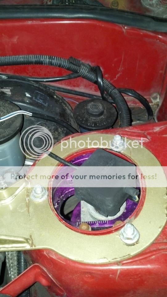

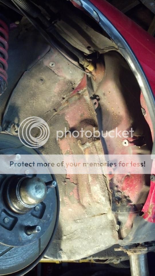

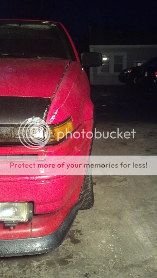

it's pretty obvious there's chassis ripples in the 'drivers side inner fender' pic. the wrinkley panels at rear of wheel arch about where the firewall is. this is usually a strong area of the car so it must've had a hard hit from underneath is my guess? are there any bent chassis rails underneath or did you once have a strut or wheel come off at some stage?

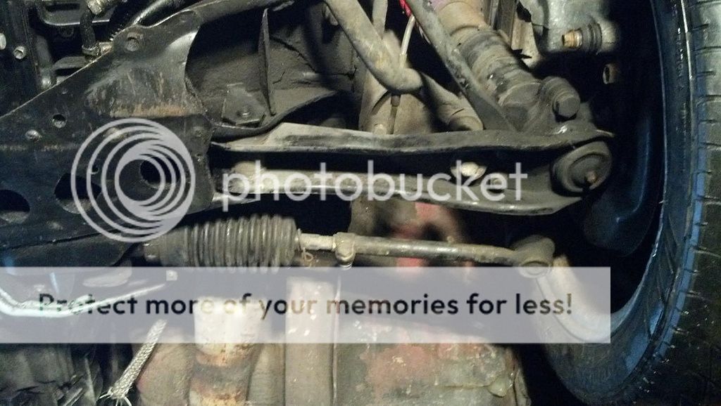

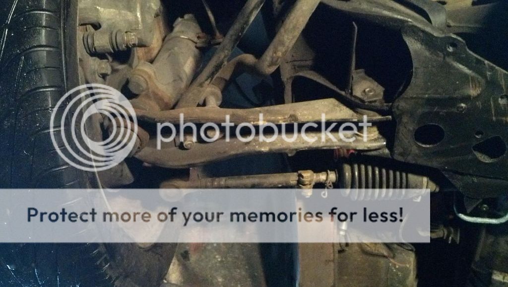

A well known mod is to use ke30 or tt132 corona lca's which are 10mm longer than E7. and i think slightly longer again than ae86. its gives you an extra degree of negative camber and adds a little bit of caster once you wind the caster all the way forward.
