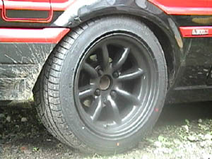

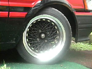

To get a ballpark idea, this was taken from the old forums wheel guide thread:
SSR Formula Mesh (15x8 -2 offset)
Watanabe Type F8 15x8 +3
Tire sizes were not posted, but it sounds like you have a good idea on how 205s will sit on an 8 inch wheel.

Fairly good, if I'm honest it looks like the Watanabe's are on 205's. Guess we'll see, worst case I am "Forced" to install some fat rear overfenders
