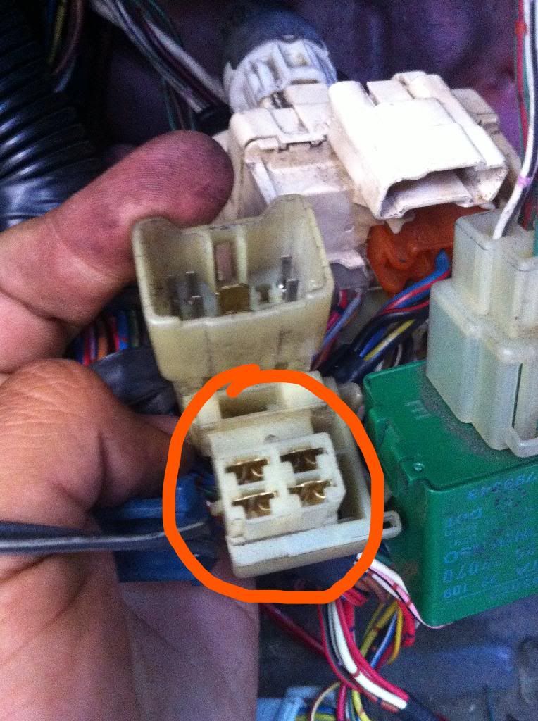

I might have found my problem. I have a plug that's on the drivers side interior fuse box(right side)that's not connected. I traced the wires back to the ignition switch so it has to go somewhere I just don't where.
(Pics alittle weird connector is dismounted and flipped back)
Anyone know what plug into it or where it runs?

Thanks for the link to the wiring diagrams. I found what plugs in there, but I've been busy trying to get the car road worthy. It is the starter relay, other relays might fit but won't work. Thanks again yoshimitsuspeed
