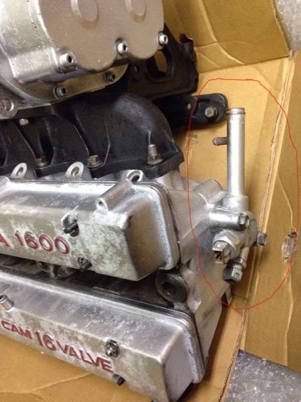

Iwould you be willing to do some custom fabrication? I want to reroute the coolant temp sensor and the cold start sensor to the rear of the head...ill post a pic soon...but just let me know if you are willing
- Club4AG MASTER
- Posts: 2084
- Contact:
Re: hks supercharger
Rhank you man...give me a couple of days to figure it all out and i can send you the specifics
