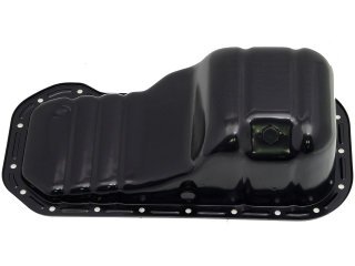

As to using an oil cooler with a blacktop and keeping the stock look, purchase an oil pan for the All-Trac Corolla(AE95), it uses the same pan as the 20V, and has an oil cooler return built in.

Thanks for the replies....mine looks like the oem oil cooler. However the bolt on the oil pan feels so tight yet it still wants to leak. I tightened it pretty good but I'm afraid I'm gonna strip it if i go any more. It looks like it has a helicoil for the threads.
Plus the bolt got really tight only after it going halfway in...then i had to gorilla it in to at least get to seal a little. Is this normal? I don't believe i cross threaded it but it may have already been cross threaded from the previous owner.
Re: Oil cooler woes
You can try heating the copper sealing rings with a torch and quenching it in water to soften the sealing surface and add a small amount of gasket sealer around the rings. You can fill a tap with grease [to catch the chips] and run it into the hose attachment boss to clear out the threads. But the only safe bet is to remove the pan and run a tap thru the boss on the bench so it can be cleaned. DaveW7
