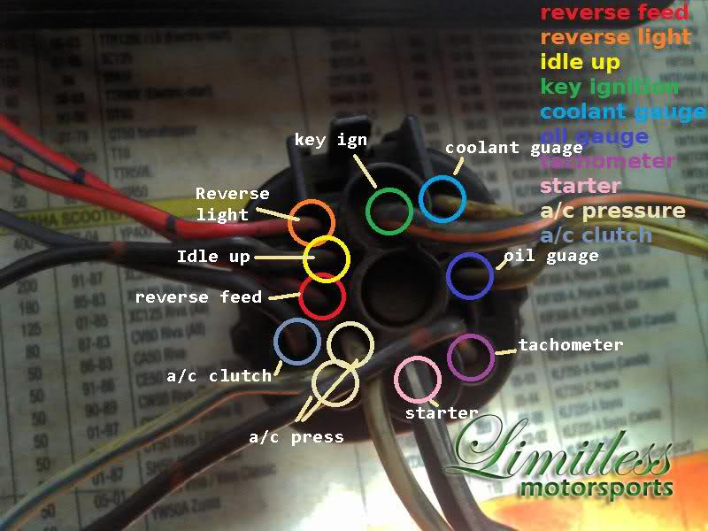

On the USDM GTS the tacho gets its signal from the black wire on the igniter.
The SR5 will get a signal direct from the coil negative. The black wire finds its
way to the big square(ish) plug on the firewall behind the engine, and from
there to the OEM tacho.
According to this diagram...
... all you need to do is connect the black wire (that leads to the tacho) to the
violet wire out of the tach adapter. Note that the tach adapter needs its own
key-switched 12V supply and chassis ground.

Yes I wired everything just like the picture with the black wire to the violet on the adapter. but did I grab the wrong wire? I used the wire that is black with what looks like brown dots on it? is this not right?

Sounds like the right wire, you might have to trace it back and see if there are any shorts on it. Even possibly that it could be the wrong wire there are a few that look the same.

IT does look like the idle up and rpm gauge wire look similar so I will look again it just sucks cuz the previous owner cut a lot of those wires haha

Hopefully you have a multimeter.
Set it to check for continuity and test between the "black" wire you think is for the Tach, and the black wire going to the igniter.

ok so i have double checked that it is definitely the correct wire that i used for my tach adapter so now im not sure why it wouldnt work unless the tach is actually bad lol the one thing i havent tried doing is simply putting the tach directly to the msd box without the tach adapter
