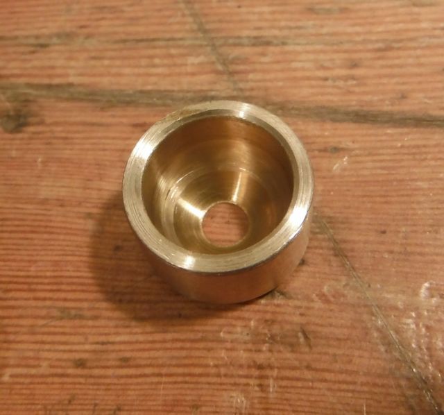

If you have a T50 shifter plus calipers, would you measure the ball for me?
I'm making a batch of bronze shifter bushings and I want to make sure the shifters are all the same.
Mine is .5495" or 13.96mm.
Thanks!

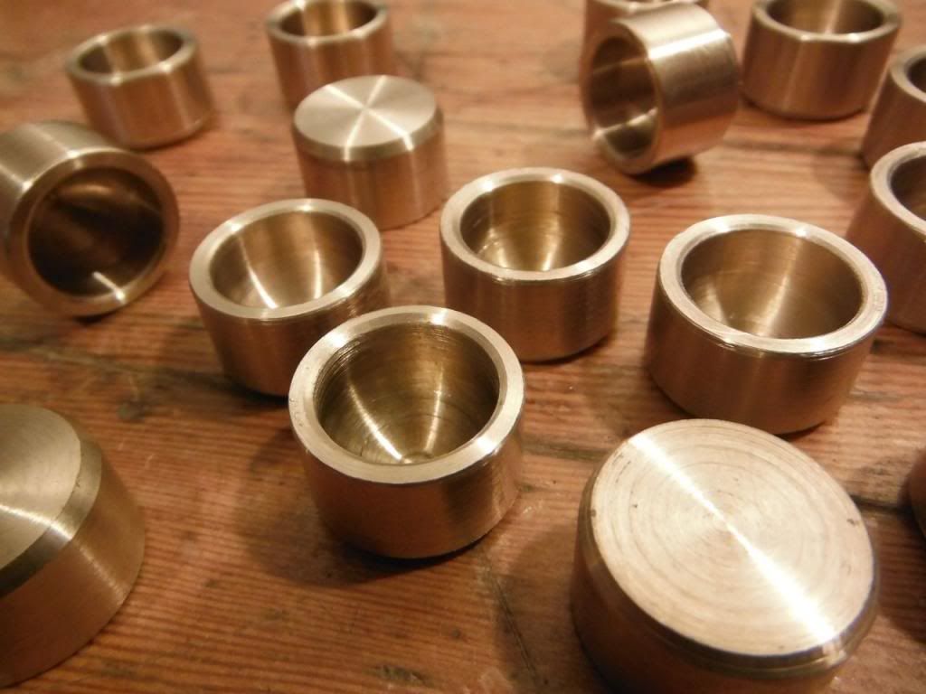

Thanks a lot guys. These are all in line with what I found on a few shifters.... So, I made a batch.
I will offer them for sale in the next day or two.... I need to confirm the shipping to the USA. I'm hoping for $24 including shipping... but that's with no tracking... I'll start a For Sale thread soon.
