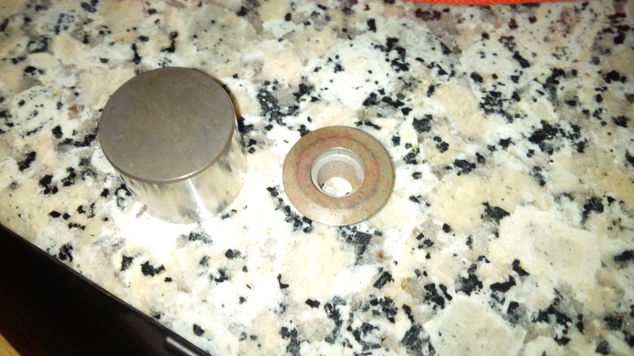

Postby speedmaster » Tue May 05, 2015 2:31 am
Something like this

Are those your actual parts ?
If so then these people can supply a 'button' type shim that fits inside the spring retainer:
http://www.arrowprecision.com/14-shims
speedmaster
Posts: 234
Joined: Tue Jan 22, 2013 9:44 pm
Location: Malaysia and Brunei
Re: 4age 16v shim retainer
Postby speedmaster » Tue May 05, 2015 6:20 am
totta crolla wrote:Are those your actual parts ?
this is the actual thing
totta crolla
Posts: 675
Location: Oxford U.K
Postby totta crolla » Tue May 05, 2015 12:11 pm
In my opinion you would be better off just using the top hat type shims, I use them and have had no issues whatsoever.
The shims you already have are likely to need grinding to fit and on top of that you will still need to source the 16 spring caps.
Any head that those cams are fitted into will need further machining as the lobes will not clear the head casting.

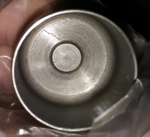

Fit all of your followers without shims, fit your cams, measure the gap, deduct the clearance required then order them pre-ground.
The caveat to this is that there is a 'pad' on the under side of your followers, can you post up a picture of the inside of one of your followers ?

Postby totta crolla » Wed May 06, 2015 8:42 am
They look a lot like my followers and if the pad thickness is the same on all of them you are probably good to go.
Looking at the link below you can find both top hat adjusters for 20v engine and shimless buckets with varying thickness pads for adjustment.
Check to see if your pads are all the same thickness, if they are different thicknesses then you probably have a set similar to those pictured here:

If some of the measurements are different then the chances are you have 1SZ buckets or similar.
If you have 1SZ buckets all you need to do is install the correct sized ones on top of the valve, no extra shims are necessary.
Just the clearance issue. But the 1sz lifters are not easy to find
quite true.... very tough to acquire... a sizing set is recommended, this is 8 of the thinnest 13751-23030, and then checking the clearances and ordering the correct set based on repeatable accurate measurements. I went through this in OST-026 - viewtopic.php?f=7&t=10783
speedmaster
Posts: 234
Postby speedmaster » Thu May 07, 2015 8:41 am
Maybe try asking supertech if they have such retainer. It's a waste not to use the toda shims
