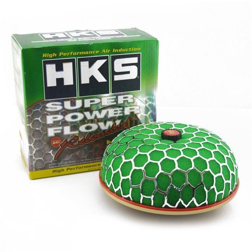

Hey Jondee,
What do you think about the popular HKS Mushroom style foam filter. There are many Ebay knockoffs circulating as well.
http://www.ebay.com/sch/i.html?_from=R40&_trksid=p2053587.m570.l1313.TR0.TRC0.H0.Xhks+mushroom+filt.TRS0&_nkw=hks+mushroom+filter&_sacat=0
Deuce Cam
Posts: 1346
Location: AZ
Re: Talking about Air Filters...
Postby Deuce Cam » Tue Jun 30, 2015 12:38 pm
^If you search around online you'll find that they have a bad reputation.

saiGone wrote:What do you think about the popular HKS Mushroom style foam filter.
If you look at the pics I posted further up, you will see a double layer foam
filter that might be fitted to a 400cc dirt bike. So you might expect that a
foam mushroom filter fitted to a 1600cc car engine would have four times
the surface area. But obviously this is not the case.
So the only way that the mushroom filter can flow enough air for the car
engine is by using a low restriction filter material, which by definition will
not have a high filtration efficiency.

Dry Metallic Mesh Type Filter Poor.......... Zero Maintenance, Lifetime Use............. 13.9 bhp
HKS Mega Flow
Image;Image
Wet, Foam type filter. ......Very Poor Throw away. Change Filter every 10,000 Miles. 13 bhp
Apexi Power Intake
Image;Image
Dry, Mesh type filter. Excellent Zero Maintenance - Lifetime Use. 14 bhp
K & N Filtercharger
Image;Image
Wet, Mesh type filter. Good Lifetime Usage - Inspect every 30,000 Miles or 12 Months
Clean and re-oil, if appropriate. 13 bhp
These pics are from tests carried out some years ago on filters sitted to Supras, and
are only included for educational purposes. The Ebay mushroom filter linked above is
described as "HKS Style" which is market speak for counterfeit, so it is likely that the
performance would be worse than a genuine HKS filter. Which filter people use on their
car is a matter of personal choice. It is not a safety item so pick the one that suits
your requirements for price, style, color, size, maintenance and performance.
