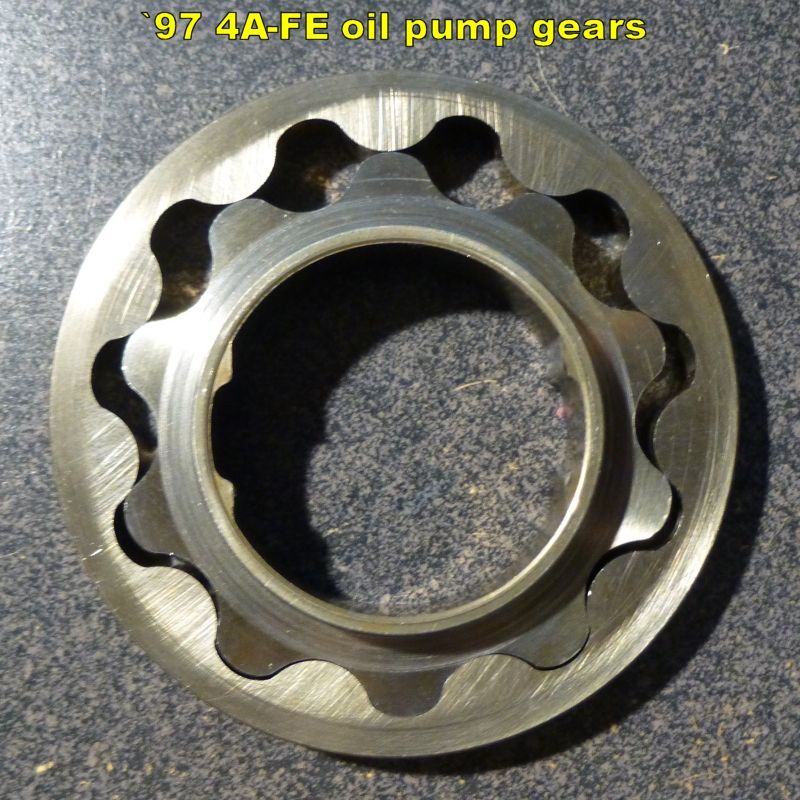

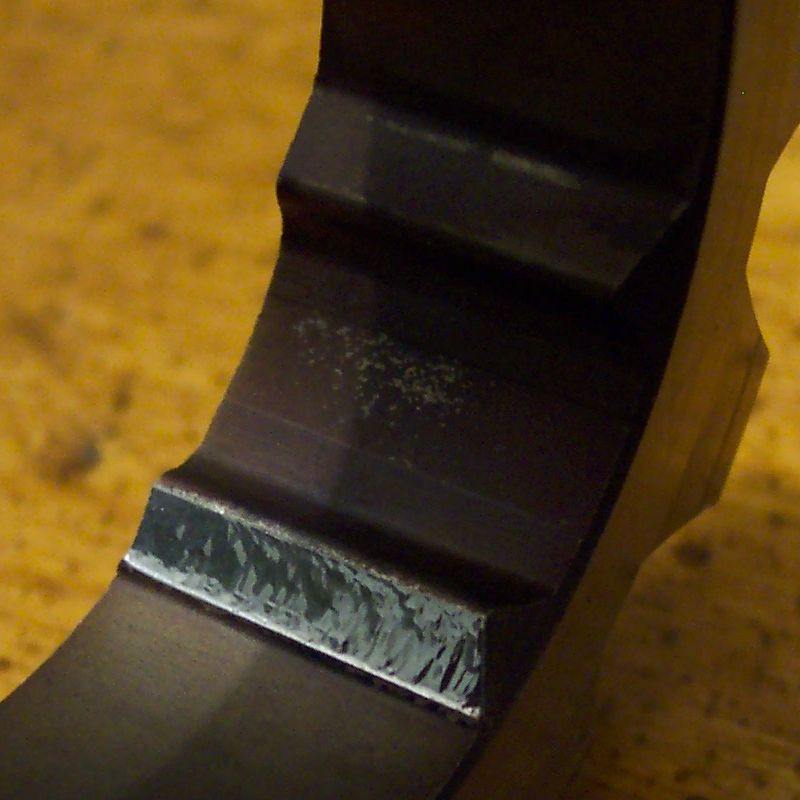

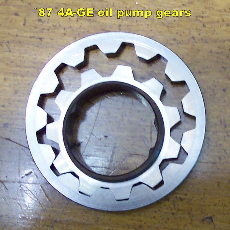

I think I've posted these pics before in an oil pump topic here. Anyways here are a couple of oil pump gears I have sitting around:
^ The last pic shows wear on the inner gear (drive gear?) where it contacts the crankshaft. I'm wondering if it's possible to safely reinstall that gear "backwards" if reusing the pump, so that the crank will contact a fresh surface instead of the surface it had previously contacted (and wore down).

Rogue-AE95 wrote:I'm wondering if it's possible to safely reinstall that gear "backwards" if reusing the pump,
Theoretically, if the tooth profile is symettrical (and it appears to be), you could
reverse the rotor. However, as it appears to have a collar on one side, there may
not be any practical way of reversing the rotor. Plus, once the two gears have
"bedded" to each other and to the housing, you could find that reversing them
might lead to accelerated wear, as they go thru a new bedding in cycle.
The markings on the wear face are interesting. I have read that with sintered
gears, the pore structure of the material leads to micro pitting, and then failure
due to cracking between the pits. Kind of like joining the dots So if those marks
can be felt when you run the end of a scriber over the surface, that would be
spalling, where small flakes of material have broken away from the surface.

Cracked rotor from the Nissan forum linked above. Same design as the later Toyota
pump, but with only 11 teeth, so placing the driving face under the weakest part of
the gear. As the driving face erodes from repeated inpacts, the amount of "backlash"
between crankshaft and rotor increases, and the impacts become gradually heavier
due to the greater lash. At the line of impact erosion and/or pitting will lead to crack
propagation and eventual failure.
As mentioned above, light flywheels, removing the harmonic balancer and power
enhancing modifications can alter the torsional vibration characteristics of the
engine. It is not hard to imagine that it is possible to inadvertently create a critical
and harmful frequency within the engines operating range. When the engine runs at
that particular rpm the result is a severe "chattering" or extremely rapid forward and
back rotational movement of the rotor on the crank.
Resonant frequecies can break cranks, so breaking an oil pump would be easy

kind of agree... I'm not saying that there isn't any cavitation effect, but the pressure fluctuations caused by many things (operating outside typical range... etc.) I also believe is the larger of the problems.
A few areas I still wanted to work on when I was porting the pump....
1) "opening up" the bypass hole to accommodate more bypass volume. When I say opening it up... the hole would be larger, but the upper edge of the hole would not move up, the larger hole would be to keep the current top edge (pressure point), but open up below that to accommodate more volume if needed.
2) The oil outlet suffers past a 90 degree turn. I did part of the work in my porting thread, by working the short radius some, but a wedge shape fitted at the right point would reduce a great deal of turbulence
Getting back to cavitation... yoshi... the low side you mention is needed as suction to draw the oil from the pan,
as far as the older pie slice pumps sharp toothed pumps, the newer pumps appear to be better finished.
Comparing similar areas....
Old pump on left, newer on right. Some things were changed besides the gears... the orange arrow points to a different shaped chamber on the high pressure side. the red arrows show that the newer design shrank the gap between low pressure and high pressure sides. Finally, the newer style has more support - around the circumference - note the green arrow shows the shelf on the new, while the question mark shows the absence on the old
Now CnCing the entire housing from a single piece of billet might provide you with some cavitation drops
