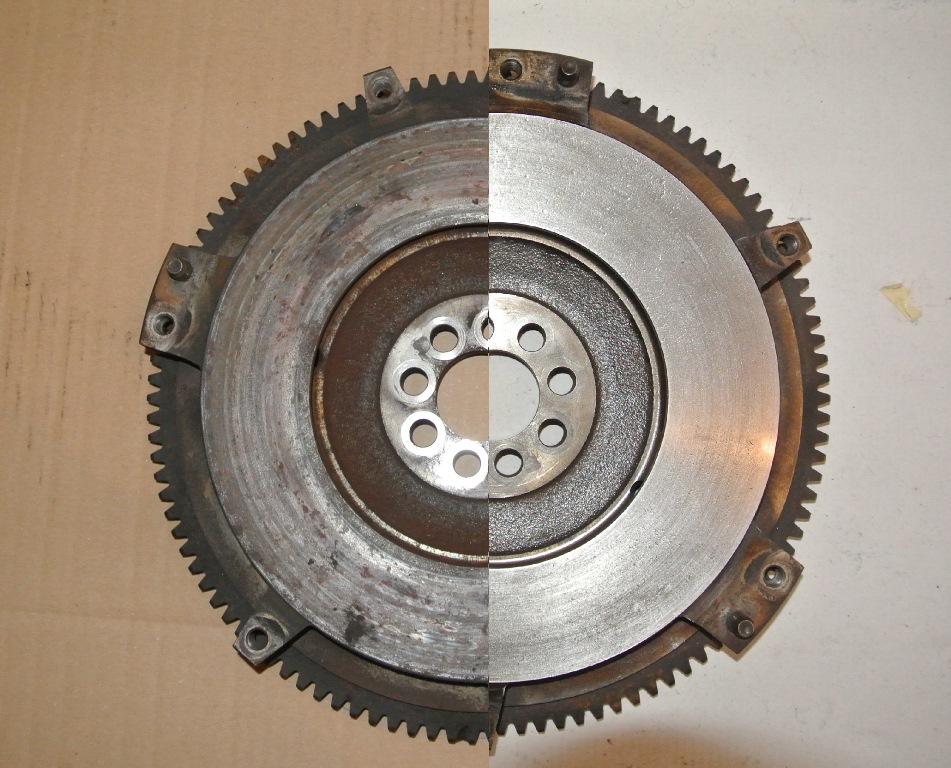

Postby mr2mk1hero » Thu Apr 09, 2015 9:19 am
Just to check in and let you guys know I'm not dead :)
All the parts have arrived. Just waiting for the water and oil pumps from yoshi.
Been busy and restored the dizzy heat shield, spark plug valley cover, EGR assembly and had the blacktop flywheel from bk resurfaced. Below are step-by-step videos with details of all the rust removal, paint stripping, painting with high temp paint and paint baking. Learned a lot in the process and am satisfied with the results considering its my first time doing this. The engine bay will definitely look much nicer. I plan to restore every bit like this.
Here links to the videos:
EGR restoration: https://www.youtube.com/watch?v=bVCmZMKeCMk
dizzy heat shield restoration: https://www.youtube.com/watch?v=ILwSIi0lAro
spark plug valley cover restoration: https://www.youtube.com/watch?v=WFOoqlER10Y
blacktop flywheel resurfacing: https://www.youtube.com/watch?v=ljV2QWngjdw
Made a FB page of the site: https://www.facebook.com/driving4answers
If you got time and willpower on your hands, do give it a like, much appreciated :)
