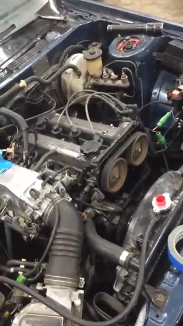

So the car has a recently rebuilt (by previous owner) engine. When i received it it had 0 compression due to the Exhaust cam being 180* off. I re-timed the camshafts and it fired right up. The car idles perfectly and is timed at 10BTDC.
Heres the problem when i go to rev the engine with anything more than super light throttle the car starts to misfire. And possibly even backfire? I can hear the misfire coming out of the intake tubing and the exhaust. It sounds like a muffled machine gun. Kinda like when you try to rev a motor that isnt timed and it starts to stumble the more you rev it.
Ignition Timing 10BTDC
Cam Timing: All 3 timing marks line up
Replaced TPS
Replaced Coil/Igniter
Replaced Dizzy, Dizzy Cap, Rotor
Replaced Wire-set
Replaced and Gapped Plugs
Replaced ECU
EGR Has been removed (misfired when it had the EGR)
1-3-4-2 Firing order on wires
The only thing i have not tried is replacing the AFM because i dont have a spare, and removing the cat to see if the exhaust is clogged. Theres is also no registered codes. I tried seeing if maybe the injectors plugs where on wrong and they arent. If i unplug a spark plug wire it will miss worse, same if i remove an injector plug. I do notice that the resistor box doesnt seem to get hot (im not sure if its supposed to get hot to the touch) The exhaust manifold does have a small hairline crack, but i dont think thats the culprit. The only vacuum lines i still run are TVIS, Small Green valve next to AFM, and FPR. If i unplug the AFM the car dies. If i unplug TPS it seems like nothing happens. I am stumped guys, and im not sure where to go from here. Any help is appreciated.
Misfire when revving, but not at idle

Ok guys an update:
Ignition is advancing like it should
CLeaned MAF - No Change
Tested MAF per FSM, MAF is Good
Pinched off Fuel Return - No Change
Found vacuum leak @ Cold Start Injector - Fixed Lead - No Change
Deactivated TVIS (To Lean Car out) - Seems to rev a bit better, but still misses
Cat is Not Clogged
Compression Tested - 182 lbs. all across the board (A bit high for a Largeport??)
When i pulled the 3rd Cyl spark plug it was fouled out, like super black.
So im leaning toward a stuck open Injector?? Leaky Injector?? Bad wiring?? Am i heading to the right direction?

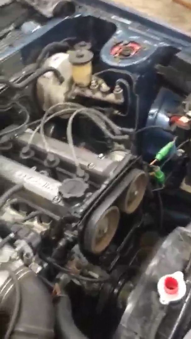

Videos of the misfire: WIth Cat on first and WIthout cat (More noticeable)
