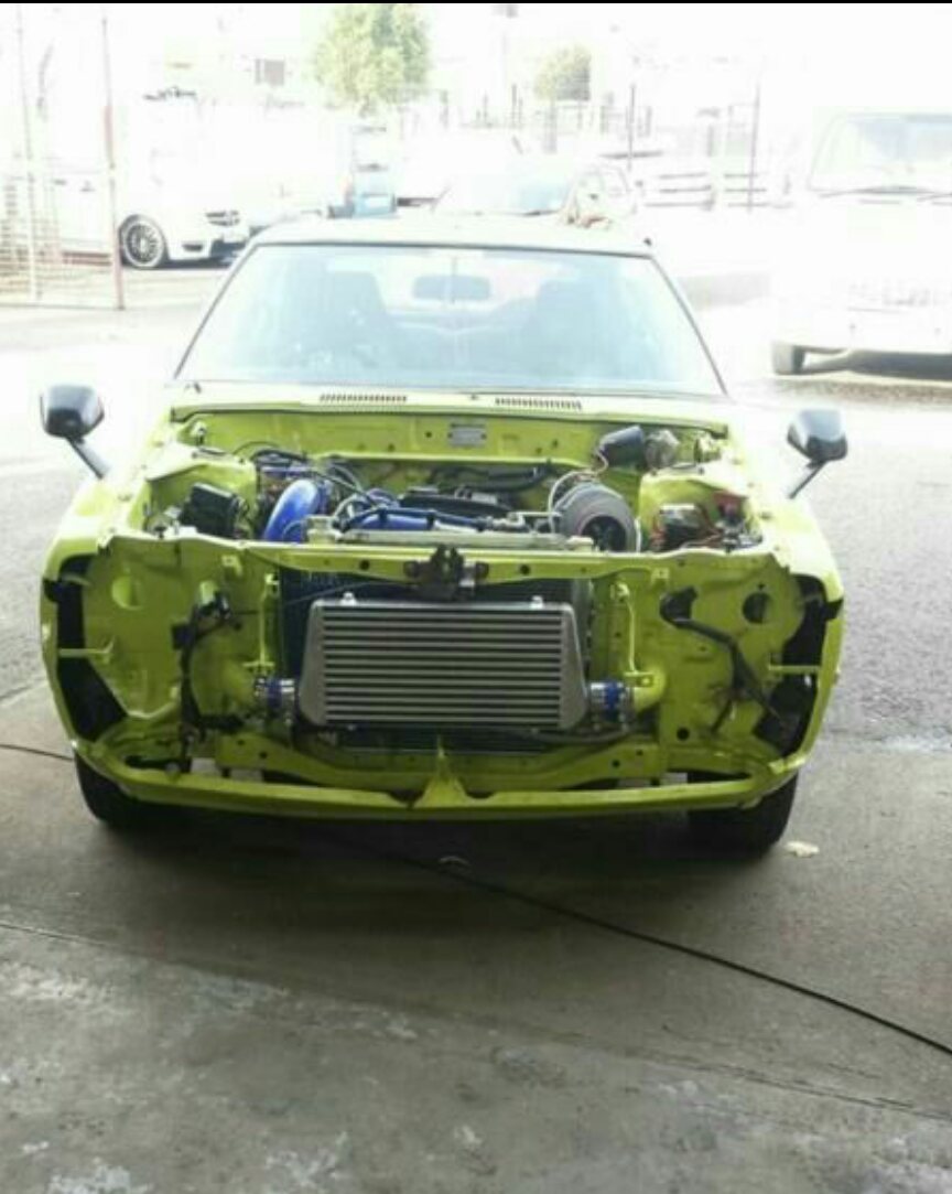

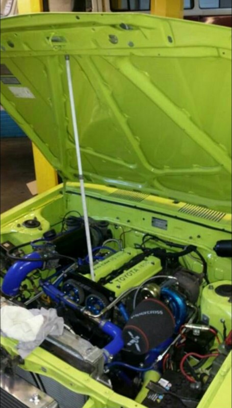

We at Twam-Tuning have built a number of 4age, 4agze and 7afe/age Turbo's, and do not cost a fortune. And we get between 275bhp to 310bhp. Yeah we use the 7rib block's. T3 turbo, what ever intercooler we find, bosh044 fuel pump and Mr turbo efi. Most of are part's are used and from cars at the breakers yards like the Turbo's and intercoolers, great fun building Frankenstein's lol
post of those builds if you can. Sounds intersting

ImageImageImageImageImageImageImageImageImageImageImageImage<br />

Postby jinx » Tue Nov 10, 2015 9:52 pm
Nice projects! Heck, each of those deserve their own thread, with a small writeup on the ingredients
You don't see too many 4AGTE setups posted anymore it seems

jinx wrote:Nice projects! Heck, each of those deserve their own thread, with a small writeup on the ingredients
Thanks jinx, yeah I can't understand why not many people do turbocharge them, it's not expensive and to get 300bhp out of a 1.6 is great.
