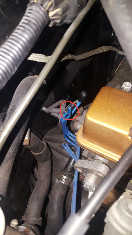

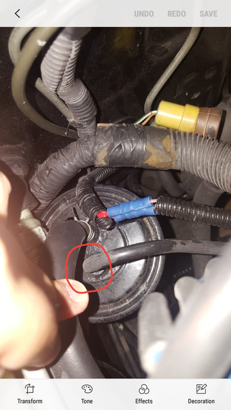

Ok so I finally needed more gas and so I filled the tank up again and came home and parked in the garage....about 20 mins later a strong smell of gas coming from the garage so I walked around to the fuel door and there is a puddle of gas on the ground so I opened the fuel door and there was gas leaking out. Unscrewed the gas cap and gas was sitting in the top of the neck nozzle so I popped the hood and checked the charcoal canister like Jondee86 suggested and I saw on the top of the canister 2 lines at the top of the canister one said purge (see pic)
followed the line to the back of the head (see pic)
and I had capped it off when I deleted the egr system. uncapped it and went back to check the fuel nozzle and the gas was already backing down the nozzle. Looks like it's fixed. Thanks again Jondee86.
