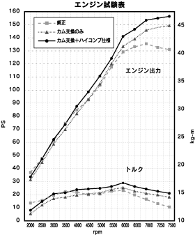

yoshimitsuspeed
Posts: 2084
Re: which engine has more potential for more power?
Postby yoshimitsuspeed » Wed Dec 17, 2014 11:47 pm
Moto-P wrote:No that's what I mean though. Most people in AE86 domains don't consider $5000 to be economically feasible in most cases. Regardless of AE86 or FR-S, and outside of pro-Drifting, huge power requirements and expensive custom engines tend to keep people off track, lots of downtime, and to me that's the biggest expense of cars we love to drive most, downtime and garage time.
It really depends on what you are trying to do though.
On the C4AGE FB group seven out of ten people would suggest an SR20 swap or something like that as though the average car person can do that for a grand in a weekend.
That $5k includes ending up with a fully rebuilt engine with a couple grand in performance parts and a quality build.
This is especially useful if you are getting to the point where you need a rebuild anyway. Then you are looking at increasing your budget by 50% to increase your power output by 50%. In the car world those are not bad numbers.
It's also why I often highly recommend building your dream motor on the side while still being able to drive your car.
If you can get to the point where that motor is sitting on the stand looking all shiny and begging to be reved up chances are you will have the followthrough to swap them out and have it running in a couple weekends.
The most important thing is being realistic with your skills, your time and your budget.
My first 4A "build" started when I blew up the supercharger on my AW11. It was my DD so I ripped out the SC and converted it completely to NA in a weekend.
I then saved up parts and planned the build for about 6 months. When I had everything and was ready I pulled the car into the shop NA on a sat morning, worked straight through and pulled the car out making boost sun evening.
Being a welder, fabricator and mechanical designer definitely helped make that happen.
My next project was my Blacktop turbo and that took about 6-8 months of the car being parked. It did take time and their were risks. Had I gotten laid off mid way through like I did a couple years later the car would still be in pieces. I would still take that gamble in a second and am very happy I did.
I could have/should have built it on the side but since the motor in the car blew up that wasn't an option.
yoshimitsuspeed
Posts: 2084
Postby yoshimitsuspeed » Thu Dec 18, 2014 12:04 am
kidsharingan wrote:are there any good after market racing cams for 4age blacktop? if there is, has anybody here tried that? whats the output?
I know you are new and I feel like everyone has been pretty patient and helpful asking each and every one of your questions that show you have done absolutely no research yourself and would rather just be spoon fed each and every answer but I gotta give you a bit of a hard time at this point man.
Long long ago some genius invented this thing called a search engine. People used to use this "engine" to learn things they didn't know the answers to.
It works like this.
http://lmgtfy.com/?q=4age+20+valve+performance+cams
In the first three links you will find Kelford and Tomei. The poncam is made for both the 16v and 20v.
http://lmgtfy.com/?q=4age+20+valve+cam+dyno
In the images the first one is a dyno comparing stock to poncams.
I have posted a couple links to my website in this thread.
There is also a link in my sig.
There are dozens of writeup pages with tons of info.
There is a whole section in the store devoted to 20v cams.
It's even right in the store navigation tab under 4AGE.
http://www.matrixgarage.com/store/20-valve-4age-cams
Some even have dynos.
I haven't gotten adding all the cams I can get but it's a start.
This has all been hashed to death ad nauseum.
Yes there is a lot of bad information out there so after doing lots of research you come back here, summarize what you have learned then ask educated and partially knowledgeable questions that people like me will be excited to help you with because it starts to get into the advanced side of tuning and tries to take the evolution to the next level.
If you rely on us holding your hand through all the grade school stuff by the time you get to the good stuff we will all be exhausted from answering over and over the same old questions.

Thanks for the link sir . I already saw it. So has any one here tried that racing cams from tomei and kelford? And what do you guys think about those claims that they have. So i guess that the tomei poncam 262 cam is the maximum cam that can be use with the stock ecu and stock valve springs? because on kelfords much higher duration cams they are also recomending some replacements for the springs.. thanks ... i might as well bought these cams and have them installed during the engine swap.

PonCams are very good cams. They put a lot of time into that profile, with engines on dynos. Most cams are based off some math, and simulations, and experience with similar engines. Tomei did testing and interating with an engine on a dyno. They're, hands down, the best money spent on a 4A and stay relevant with a lot of other modifications.
Pursuing the ideal
Posts: 2214
Location: Portland, Oregon
Postby oldeskewltoy » Fri Dec 19, 2014 9:42 am
burdickjp wrote:PonCams are very good cams. They put a lot of time into that profile, with engines on dynos. Most cams are based off some math, and simulations, and experience with similar engines. Tomei did testing and interating with an engine on a dyno. They're, hands down, the best money spent on a 4A and stay relevant with a lot of other modifications.
burdickjp wrote:Don't EVER trust what someone says just because they say it. That is called an appeal to authority, and it is a logical fallacy.
Trust the evidence, not the person.
So where is the evidence.... a dyno run on a smallport?

It's prettied for marketing, but they have one on their website. It's more than you'll find for other cams:
If I remember correctly, the bottom line is a stock smallport, the second one up is that smallport with PonCams, and the third one is with more compression. Yes, it's cleaned up for marketing material.
Here's what they say about their development process:
During the Tomei 4AG project, the main focus was aimed at the development of the camshafts which over 10 prototypes were constructed. Through undergoing such criteria as our engine bench tests, actual road tests, and noise assessment, nothing has been compromised until the perfect product had been developed. The best camshafts for the 4AG has been created.
Assuming that they know what they are doing, you'd expect a lot of 10 iterations of profiles on a dyno.
In the scientific community there are two things to help with this. One is called full disclosure, The other is called peer review. You make your data available to your peers in as open of a manner as possible, so that they might compare to their experimentation and see how their results compare to yours. I try to be as open as I can with my development. An unfortunate thing about engine development is that much of it happens behind closed doors for a number of reasons. I'm sure you, Dan, know a lot about Loynings which you're discouraged from disclosing.
This kind of development, while veiwed as necessary for the sake of competition, is unfortunate for the community at large because it encourages appeals to authority. You get conversations like, "XYZ shop has built many of these engines, so they know what they're doing, and I trust their judgement". That's, in many ways, developing in a vacuum. You don't know that what they're doing might be better or worse than shop ABC, because there's little equal comparison between the two.
Having said all of that, I've seen 16v PonCams perform above and beyond what I'd expect from cams of similar specs. Even if they only performed just as well as similarly spec'd cams, their price makes them a bargain.
