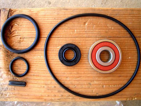

Is there any DIY way of rebuilding the CAS instead of getting the kit?
- Attachments
- Picture for reference
- DistRebuild8.jpg (65.79 KiB) Viewed 6118 times

All the parts should be available from industrial bearing and seal suppliers.
You just need to give them the details... maybe take the CAS in with you so
the sshop can measure the O-ring grooves to make sure you get the correct
size. The O-rings become distorted after a few thousand heat cycles

I have a problem looking for a small black seal.

Nothing unusual about a 10 x 20 x 5 shaft seal. Tell your supplier to try harder

I changed a few and still leaks. OK thanks jondee
