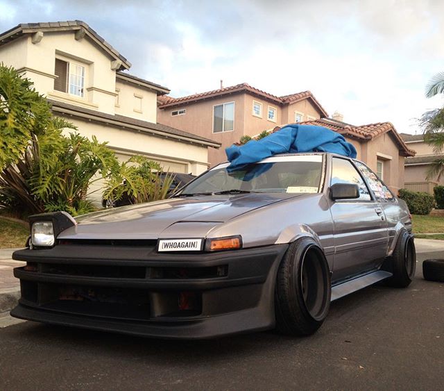

Hi guys, im new to the Club4ag group and im kind of new to ae86's.
I have a 85 GTS Coupe. But my differential started knocking all of a sudden and im unsure what it is. It is welded, and i have tried flushing and replacing the rear end fluid and that didnt change anything..

- my 85 sr5 coupe
